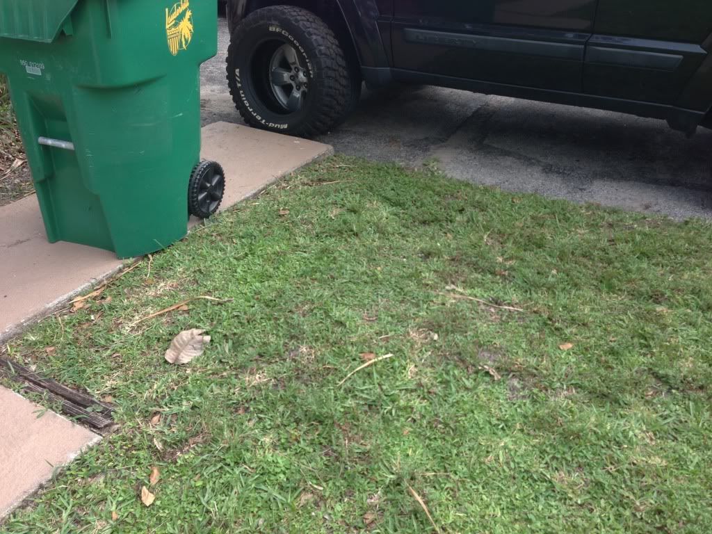

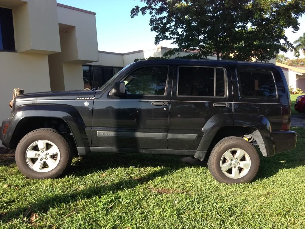

done with my ome lift...........
love it. and no noise at all....... so far
just a tease of what is coming probably next week. km2 mtr's

What size are them tires ya got there?

245/70/17 mtr km'2 just waiting on the new wheels. this is a 30.5x9.65 inch tire. should not have any issues.

Lift looks awesome, can't wait to get mine on!
Those tires will be perfectly ok for your KK, I have the same size on mine without a lift and there isn't any rubbing, just not great articulation. But with the OME lift it'll work :JEEPIN:

Those are the exact tires I'll be getting once these Falkens wear out... or sooner :roll:

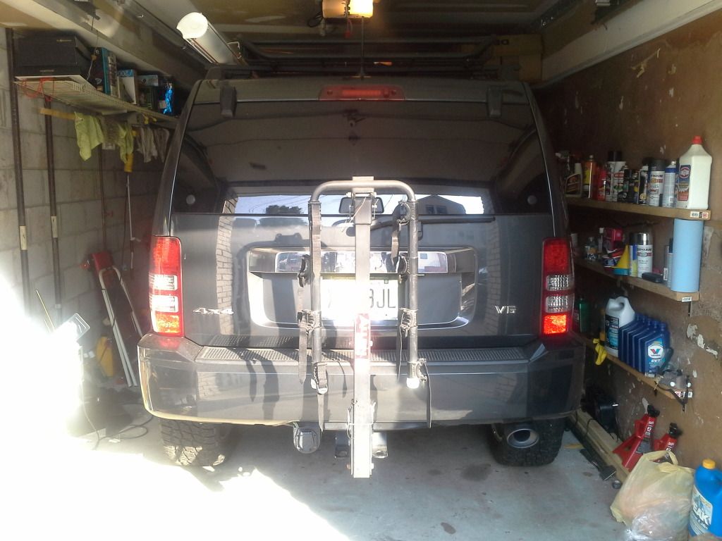

Just installed a Thule Roof Rack and Yakima LoadWarrior Basket :D
2012 Liberty Arctic 4x4

That looks great! Tell us more about that lift!
How does the HD/MD feel?
Did you measure the total height? Any top plate, clevis lift or rear isos? :?: :?:

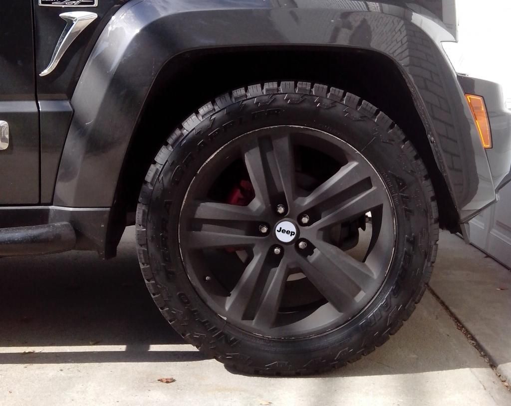

this is my newest mod-rim with jeep band name... :seuss:
All 4 rims have that "Jeep" on the center caps... :shock:
Still debating black out or black out with chrome cap... :banghead:
Tell me what you guys think?! :rockon:

Looks good with standing out alittle

I think it looks pretty good but that has to rub like a mofo when the wheel is turned at any kind of articulation

front hd springs with 3 conduit nuts and al's top plate
read md springs
i did not measure because it still setting in, the first night the back was like a 4" list and it was like riding a horse not it rides way better. love the front hd springs, on the hi way is really stable and is 200% better ride than stock.
only complaint is that the front springs are really stiff and you lose flex, maybe to soon yet to tell. but the first thing i did after the install was to mallcrawl a little. there is a set of three big drain water pipes behind a Walmart that i love to climb on, well i couldn't make it with the ome... reason, no flex... so all the front weight needs to be lifted in order to bring one wheel up loosing traction, with the stock suspension the whee could easily flex in to clear the pipe.. i will give another try later once the springs loose up a little.
now dirt rod???? to test yet.

I like the way that looks. As long as the center cap still has silver on it, it'll look good. I don't like black center caps on black rims.

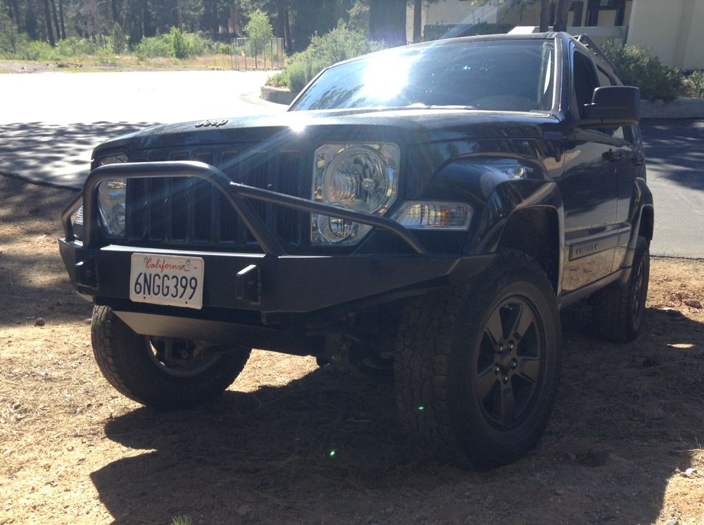

Added more to my personal bumper. More protection and gives a prerunner look. I love it.
I want those side pieces on mine ! Lol
