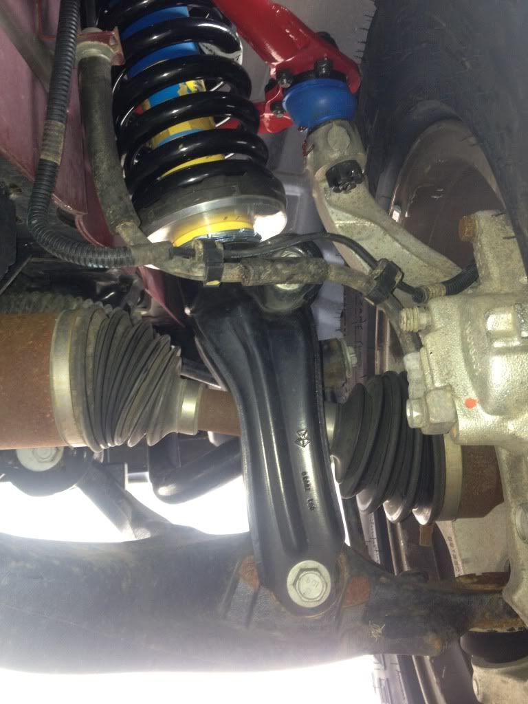

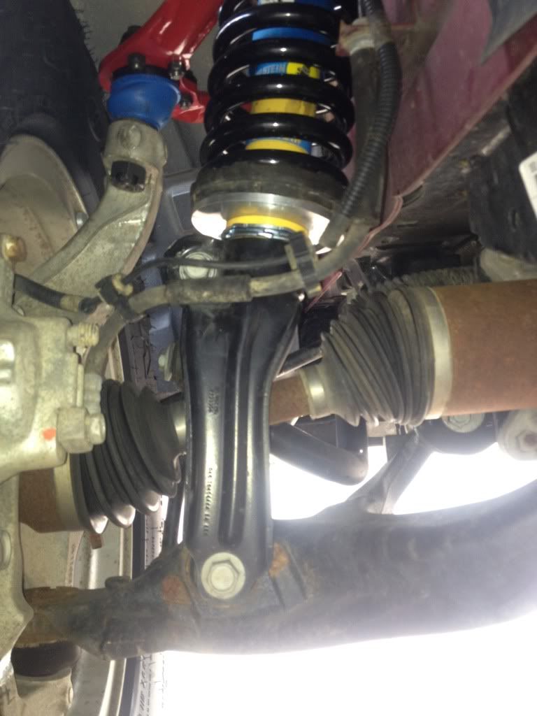

Had it aligned. I'm still getting a clunking even when driving straight. :banghead: gotta figure out why
Edit:
So I went out and measured. Sitting at 21.5 driver front, and 22 passenger front.
Driver's side CV
Passenger CV
How bad are those CV angles? Any ideas what the clunking might be? I went with 927s, 1/4 spacer plate, 3/8 clevis, als a-arms, 731s and 2 extra isos per side in the rear with bilstein shocks all around.
PostPosted: Wed Aug 07, 2013 10:41 am
Posts: 371
Location: West Michigan
I think that you uploaded the same picture for both CV's... but the angle looks fine. The clunking could be the top nut on the strut tower not being tight
PostPosted: Wed Aug 07, 2013 1:53 pm
That I did, fixed now lol. Anyways, figured it out. Turns out we forgot to tighten 1 of the sway bar bolts all the way. She rides nice. I do notice the power drop now. Just hoping my mileage doesn't go completely South on me lol. I think highway won't take a hit as hard as the city driving.
