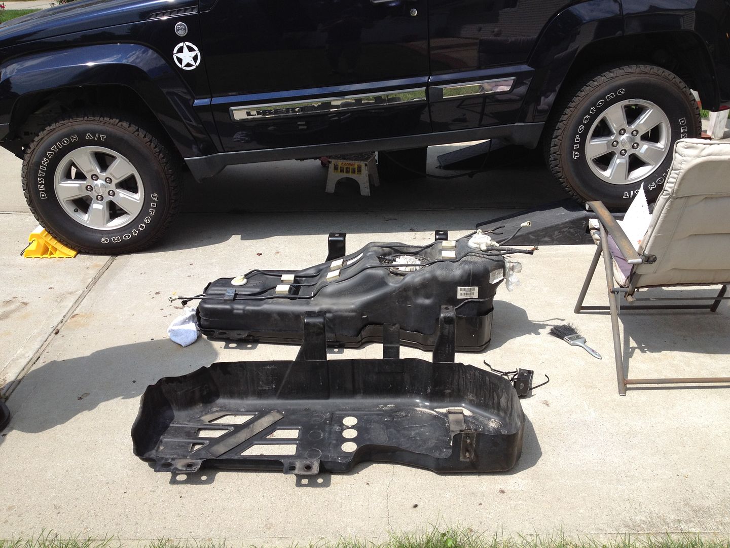

My friend came by today to help me install the mopar fuel skid.
It was the last one I needed to do, as I already have the other skids.
FYI, I'm glad they used quick connects, otherwise it would've been PITA!
Make sure your fuel tank is almost empty, and get a friend with great upper body strength to help lol
How we felt when we did this, in this order===> :banghead: :5SHOTS: :furious: :D :BANANA: :JEEPIN:

I think there was a write up here where they used ratchet straps to hold the tank up and just dropped the bracket. I'm just glad I didn't have to do that one myself; I got mine done for free when the dealer was replacing the tank for the gas spitback TSB.

We were ready to do the strap method, but after we loosened the bolts,
we saw the quick connects on the tubes and decided to just drop the tank
instead. (trust me, it would've been more time consuming trying to fanagle the straps in there)
First, we unclamped the rubber hose and disconnected the tank from the filler neck.
What gave us a bit of a pain was trying to figure which tubes goes to where,
but after dropping it halfway, we clearly saw how many tubes needed to be disconnected.
We did the fuel pump wiring last, as it was in the middle
and it had enough slack that enabled us to do it on the ground.
The key is to have the tank almost empty and have a helper. :)
