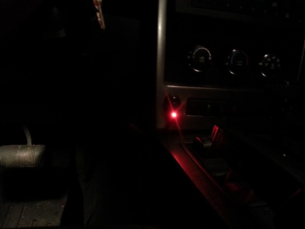

Does anyone know if a push button switch for your off road lights could potentially drain your battery? I purchased a set of 3" cube lights for my KK and I connected the harness directly to the battery so even when the truck is OFF, the light stays on (red) When the lights are ON, the light goes green. I'm just worried that having the red light on 24/7 will eventually drain my battery especially when it comes to winter time (Canadian winters)
Here's a pic of the switch/light when my truck is off.
I have a switch that stays illuminated even when the lights are off and I haven't had an issue with the battery. But the longest I've let it sit is 2.5 days or so.

Yeah there's no way I can not drive my KK for that long haha. I actually work 6 days a week so it rarely sits. Maybe just come winter time i will unplug it every time I shut it off since quick disconnects came with the harness and I put those under my steering wheel for easy access. Thanks!

If you are worried about that lighted switch, peace of mind is less than $5 at your nearest auto parts store. You could just swap it to a non-lighted switch, or one that only lights up when on.

Well the thing is I went to all stores and they don't have any switches that are just applied with a piece of 3M two-sided tape. I don't really want to drill a hole in my dash in case I ever take out my pod lights. Not really finding anything on eBay either.
Also, I think being wired directly to the battery will cause the light to always be on, no matter what switch (with a light). Correct?

I wired my lights up to the accessory relay in the fuse box. That way, unless the car is on accessory, or actually on, the switch has no power. It would be pretty easy to move the wire to that relay.

I have my lights wired directly to the battery and to a lighted switch. However, the light is only on when the lights are on. I just have to make sure i don't leave them on over night cause my battery will for sure be dead. No problems yet
