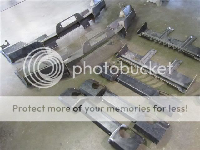

Sorry for the delay in providing an update but some personal matters took precedence.....
Monday 12/27 after Christmas I did go to my sheet metal shop and QC the last order of CNC cut and formed pre-made parts. Everything looked good so I extended my lunch hour and drove the parts straight to my street rod fabricator shop so they could go to town :BANANA: .
This past Monday 01/03, I checked on the street rod shop fabricating my initial prototypes and they had 2.5 front bumpers completely tacked up from 100% pre-made parts. They were short a couple parts to finish the 3rd front bumper fit-up. I'll be going by tomorrow (Wednesday 01/05) for final review of one of the fully tacked up front bumpers and if all goes well, hopefully I can release them to full-weld out the front bumper. There have been a few things we've been working through trying to fine-tune fit-up. They also should be starting on changing out a few parts on the rear bumper and starting to make a couple more of them too.
Today I also located my source for mandrel bending round tubing for my front bumper grille guard options. Tomorrow I'll be ordering the mandrel bent formed round tubing for my first, of several, grille guard options that bolts to my front winch bumper design. Once I have a photo of the first grille guard mock-up, I'll be sure to post photos.
I'm getting excited to, after more than 6 months without my KK, be heading into proverbial home base and moving toward completing development of my KK off-road armoring. I'm very ready to be done, to be able to install the final bumpers on my KK (along with the winch I've had since last spring) and to be able to drive, and wheel, my KK again.
I've had some PMs about how to get on the list for the first batch of bumpers and/or sliders I have produced. I recommend posting your interest in this thread, or, if you'd rather, you can send me a private message (a.k.a. PM). I'm just keeping an informal awareness at this time as I don't yet want to keep a formal list. I need to prioritize getting done first. If you go back and read my very first post in this thread, you'll note that in my business model (of having products produced in batches which means I'm financing them being made), you basically won't be paying until we know we've got product to ship so please don't think you need to be putting any money up to be on a list. I don't operate that way. Just keep saving your money for later this year if you're interested in my well-thought-out KK off-road armoring.
Stay tuned throughout January as there should be various updates from time to time as I move toward completing development of my KK off-road bumpers.

This January will definitely see some progress on my KK Off-Road bumpers. Thank you all for the interest. :D 5 weeks since I first "declassified" my KK Off-Road Bumpers and Rock Sliders and this thread has been viewed over 2,100 times. :shock:
Below is a photo from last week showing my street rod fabrication shop (which is fabricating my prototypes for me) had 2.5 full front bumpers (the third one was on my KK for fit-up and we were missing a couple pre-made parts), 3 light pod covers and 2 radiator and power steering cooler skid plate assemblies all tacked up awaiting my approval to commence full weld-out of all the seams.
It has been a pain getting the mounting for the KK's forward facing turn signal properly positioned as we had to redo it multiple times before I was satisfied. Below is a photo showing how it wound up looking. I think it looks well positioned and the plateau it sits on maintains a consistent gap to the edge of the KK's grille side that is at an angle.
The front winch-bumper in the above photo has been fit and tacked together from 100% pre-made parts (cut out on computer controlled equipment off my CAD drawings, then bent to shape when applicable).
In the above photo, you can also see one of the grille guard mounting brackets sitting above its mounting holes. For those that want to customize their KK equipped with my off-road front winch bumper even further, as I stated in my original front bumper posting, there will be multiple options for bolt-on grille guard hoops. This bracket gets sandwinched between the 1/4" formed winch mounting plate and the bolt-on 10,000 lb capacity recovery hooks.
I have 2 different raw formed "hoops" (from round tubing) on order and should be able to pick them up this week. I'm planning to bring my KK home next weekend (of 01/15-16) so I can fine-tune what I want for the basic rectangular grille guard hoop which will lead right into the wider brush guard style option. I need to spend some time looking at best options for tabs on the grille guard hoops for light mounting, etc. I'm also wanting to incorporate means to facilitate securing wiring looms going up the grille guard hoops to additional lights since I know a lot of people seem to like to mount lights up in front of the grille. That weekend I'll also then be determining the formed tubing for the forward leaning stinger option. All 3 of these options will bolt in these same 3 mounting holes on each side of the winch (thus 6 bolts total).
That's my update. Now, for some of my questions.............. :wink:
