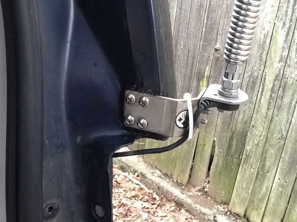

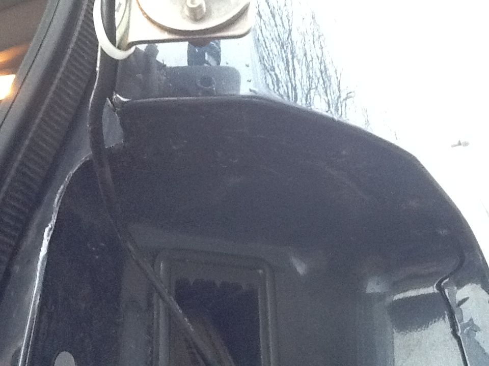

I repositioned my Firestik Antenna mount today. The door jamb mount was bolted to the sheet metal under the top of the right tail light, but vibration was causing the sheet metal to tear. I moved it to bolt to the inside of the tailgate door jamb, which has thicker metal.
The original location of the mount, holes now siliconed closed.
The new location of the mount, sealed with silicone to waterproof it.
Next up is to re-tune he antenna using the SWR meter.

SWR checked.
channel 1: 0 SWR
channel 19: almost no SWR
channel 40: 1.4 or so
All are under 2.0, so it's safe to run my CB radio. Yeah, I could tweak it a little to try and get the high end a little lower, but :juggle:
