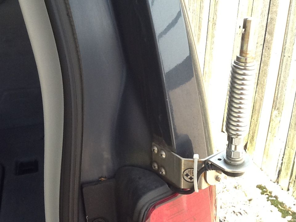

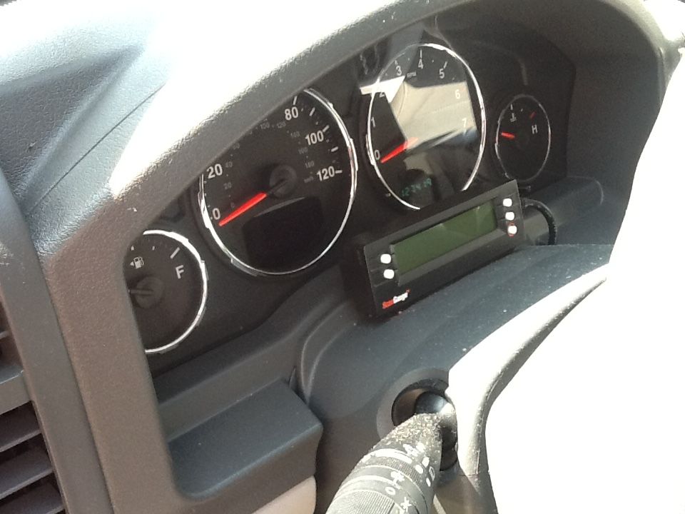

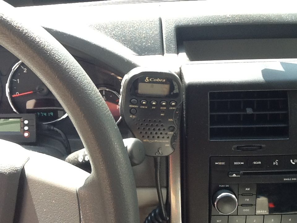

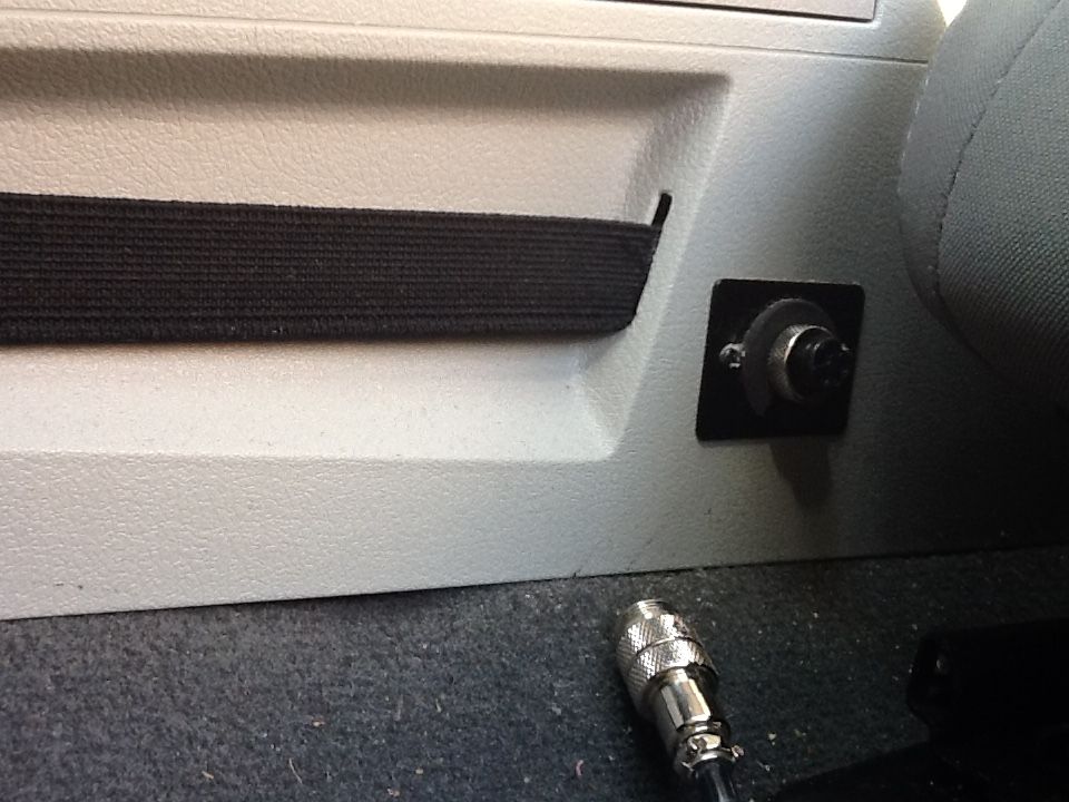

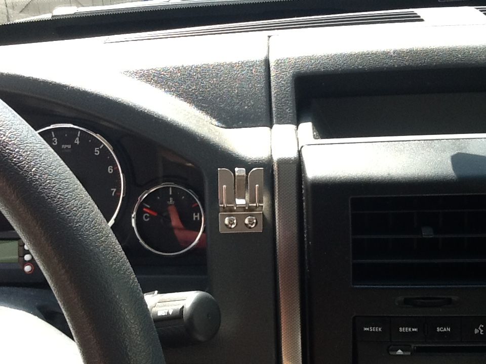

Pics as requested:
Scangauge on the steering column, velcroed in place so it can be removed if parking in the city. The cable goes behind the dash through the area where the steering wheel tilts, and connects underneath to the OBDII port.
I mounted the bracket for the CB radio to the right of the steering wheel on the dashboard.
Here it is with the CB handset in place.
The "brain box" for the CB radio lives inside the center console next to the shifter, under the 4x4 switch. The port for attaching the handset cable is on the side of the center console just behind the elastic strap and in front of the drivers seat.
Here is the mounting location for the Firestik antenna, above the passenger side tail lamp. I have a spring and a quick disconnect for the antenna attached to the mount. The antenna cable goes through the vent behind the tail light housing, along the floor under the doors behind the gray plastic interior trim, up underneath the glove box area, and into the center console area to the "brain box" of the CB.
Hope this helps! Let me know if you need any help as you run the cable. All of the interior trim pieces are held on by those metal clips, plus a few screws here and there.

Thank you! Every picture is almost exactly where I was thinking about mounting everything. Also glad to now know what that black piece was for with the CB :dizzy:

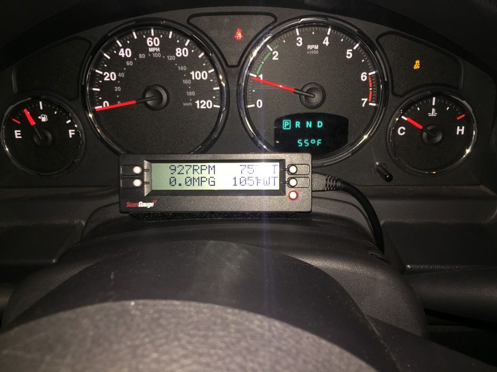

So Sunday I woke up "early" and wired and mounted my scangauge.
