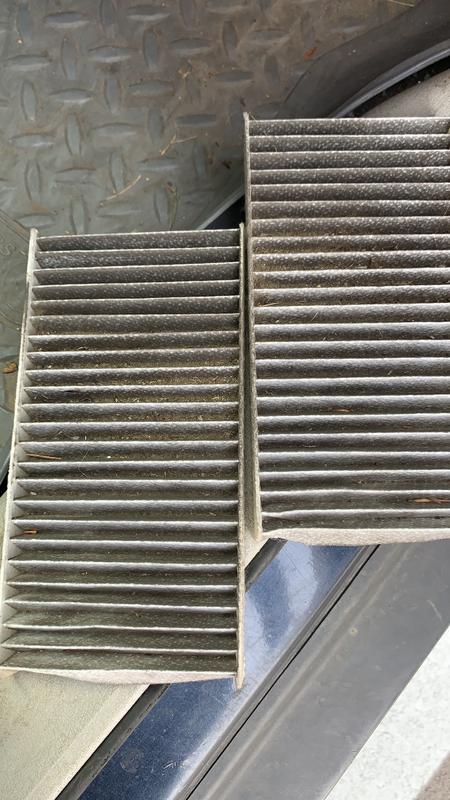

Did a little maintenance today.
Replaced :grim: cabin filters with :rockon: new ones.
If you need motivation to check your cabin filters, here it is. 12,000 miles on these, which is the recommended replacement interval. Maybe that's too long!

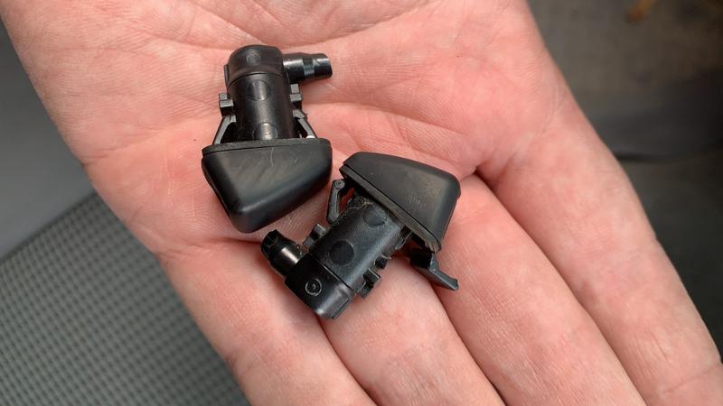

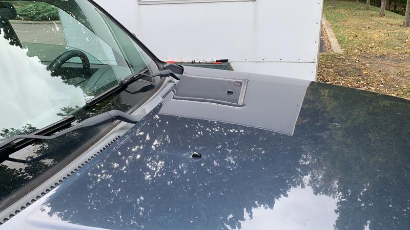

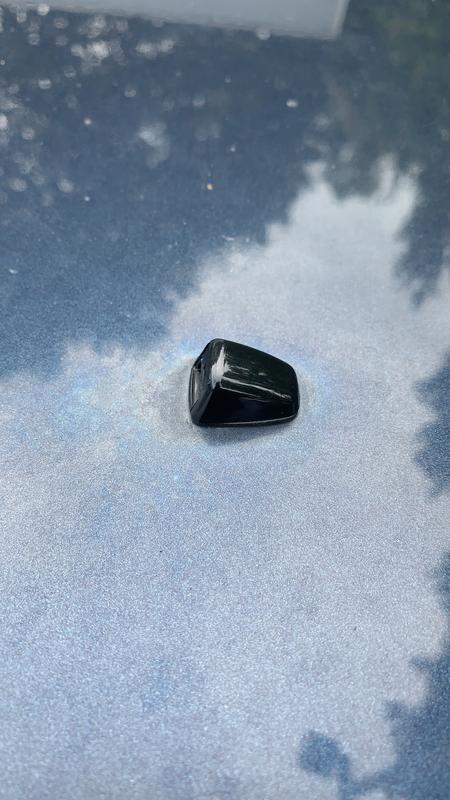

Replaced broken windshield washer nozzles with new.
Not being able to clean the windshield for the last week has been annoying. Also, the misfires caused by spraying washer fluid on the engine were not the most fun I've had.
Here's the new. Looks like a shinier black plastic than the original matte black units.

My nozzles are both worthless. How did you access them since they hide under the soundproofing mat, under the hood?

The soundproof mat is just held on by 9 plastic pushpins which you can extract with a trim tool. Once it is off, you can easily access the hose and the bottom of the nozzles. If there is part of a plastic nozzle broken off inside the rubber hose, use needle nose pliers to crush it and it should fall out. Then flush with washer fluid. The old plastic nozzles were brittle like they were made out of Cheerios. You can also use the needle nose pliers to bend (more likely break) the tabs that hold the old nozzles onto the hood. Once out, replacement is literally a snap.

Did you use MOPAR nozzles, or something from the local parts store?

I looked into getting Mopar nozzles but the best i could find was $40 each.
I went with NAPA nozzles for $40 for the pair. They ended up being aimed a little low, but it’s not a big deal.
