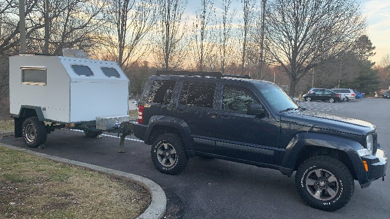

Jeep and Trailer at the end of the day. Jeepy got an oil change and passed inspection. Trailer got a new hub.

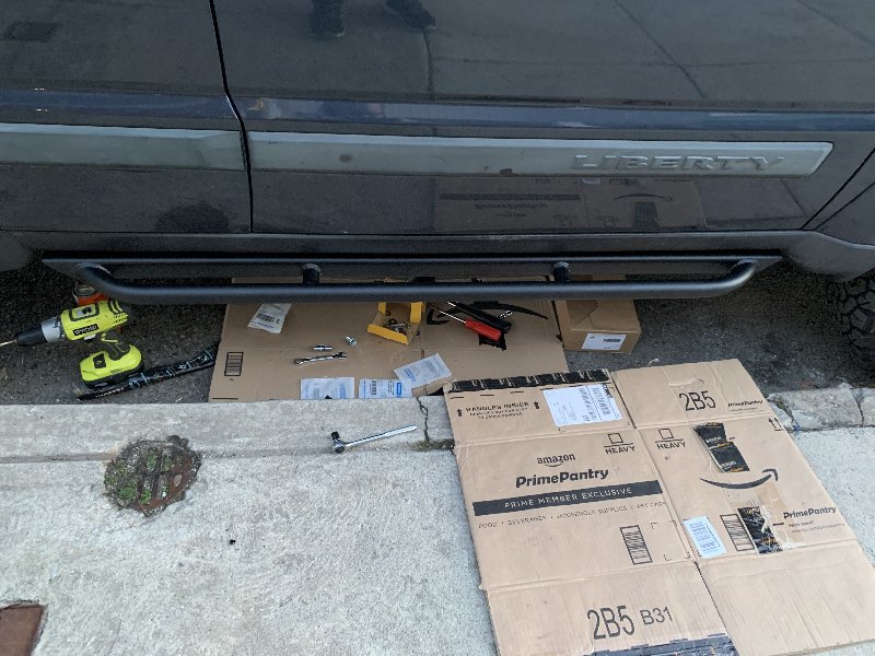

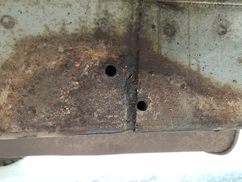

For a while now this broken bolt was preventing me from reinstalling my newly powder coated rock sliders. The bolt broke off when I removed them for painting.

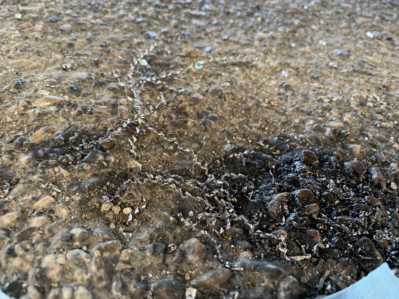

Well today the bolt met its end via being drilled out...
And got turned into this...
Which freed up the hole...
And allowed me to bolt the rock sliders back on!

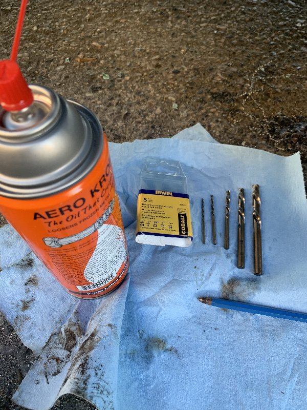

At one point I had to decide whether to use an easy-out, and decided against it and instead to keep on drilling. I had been hammering on the bolt and bathing it in Aerokroil for weeks, and it showed no interest in turning AT ALL. I was using vice grips on it and nothing, except rounding it off. Thus, I figured I would probably just break the easy-out in the hole and create a worse problem. I'm glad I just kept drilling it. I used cobalt reverse thread bits, and went really slowly, frequently cleaning the metal scraps off the bit and keeping it wet with oil.

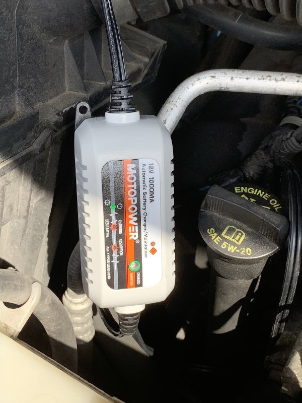

But I also remembered that not driving it might mean my battery is running low, since there are a few mods on the Jeep that draw a small amount of current all the time. I checked it with my multimeter, and I got 11.9 volts! Not good.
So this afternoon I hooked up a small 1 amp charger/battery maintainer to slowly bring it back up. No, my Jeep is not a plug-in hybrid.
Here's the charger.
The 12.85 volt reading is after about 30 minutes of charging, so it's slowly moving in the right direction. The voltage should rise to 14.5V when charging and come down to about 13.5V float charge when the battery is full. After that I may disconnect the Jeep's battery since I'm not driving anywhere these days.
