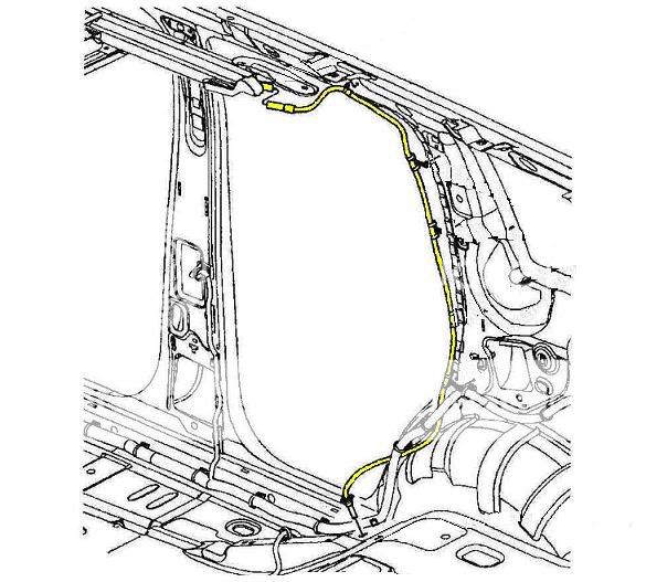

There are 2 sunroof/moonroof drain lines in the KA. I'm sure the KK is similar. (Digger, can you verify?) There have been several KA with your problem. The drain lines were plugged. Here are the locations.
Front:
Back:
If your rig is under warranty, let the dealer handle it!

There is a front hose, but I don't see a rear hose in my FSM

PostPosted: Wed Apr 15, 2009 7:15 pm
:?: well now I'm all sorts of confused... FSM only shows one that looks like it is for the passenger side, how ever I have part numbers for 4 different hoses. Front left and right and rear left and right :?
PostPosted: Wed Apr 15, 2009 7:51 pm
Posts: 1503
Location: S.W Washington
The KA has 4 lines as well. I would guess they are the same. I only had illustrations for the right side.
ESP Off Switch
Take a ride on the Trō side!
PostPosted: Wed Apr 15, 2009 8:36 pm
Yours are way better than mine. I'm going to go out on a limb and say that the KK and KA probably have the same hoses n the same places
