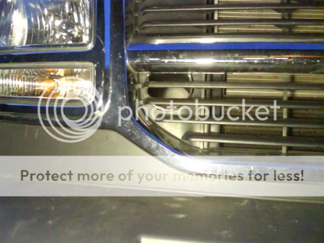

Joined: Tue Apr 22, 2008 11:30 pm
Posts: 410
Location: Chicago, IL
K & N is taking a firm stand on dealers trying to void new(er) car warranty because of an installed K & N filter.

PostPosted: Thu Apr 30, 2009 6:56 pm
Jeepin_it_real wrote:
digger you said u have a 07 KK... for the aem, would i have to make any changes tot he unit or the car in order to make it fit in my 08? i think i am going to go with the aem due to the fact i dont have to oil it
I have a 08 KK :D the 07's were still KJ's
As far as changes, you just need to drill two holes in the inner fender right next to the PCM. The KA's (Nitros) have a bracket that comes off of the PCM the that KK's don't have. Really easy to do. I also chose the AEM do the the oil - less filter

PostPosted: Thu Apr 30, 2009 8:04 pm
Taco Killer
Posts: 583
Location: Laredo TX
so after drilling those holes i can screw the intake into them or do i need to make/buy a bracket?
I did not drilled any holes on my KK....
