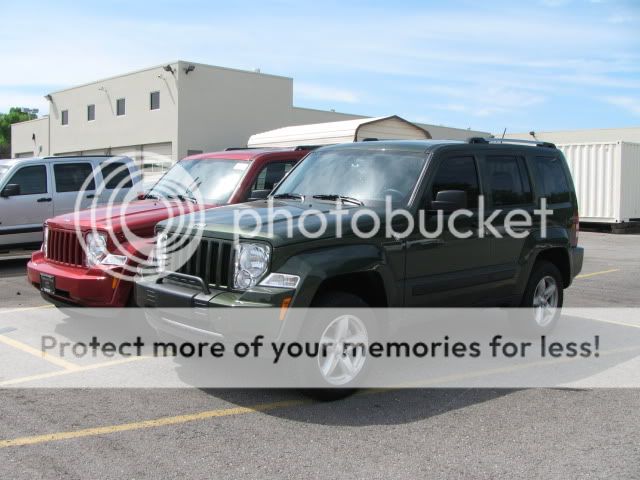

Ok, so yesterday my dad and I installed the rear of the JBA 2.5" lift kit on my KK after installing the front last Saturday. The rear was dramatically easier and only took about 2.5 hours which included one trip to the auto parts store and one to the hardware store. The front, including UCAs, took us about 10 hours or so last weekend, which included 2 trips to auto parts stores (for some sockets we thought we had but didn't).
Since I'm still undecided on aftermarket wheels and tire sizing, I'm going to go ahead and get my KK realigned this week before taking a short road trip next weekend. Even while it needs to have the camber adjusted, I agree with others who have a JBA Lift for the KK and that it rides great. The ride feels very appropriate -- just a little bit firmer than OEM without feeling rough, sloppy, cobbled together or dangerous. So far, I'm very impressed with the JBA 2.5" Lift Kit.
Before JBA 2.5" Lift Kit Install:
After JBA 2.5" Lift Kit Install (still with OEM wheels/tires):
I made notes to further refine/clarify/correct the installation instructions JBA provides (as well drafted by Scar0 during his install). I'm going to contact Marlin to coordinate the best way to provide him this feedback to benefit future JBA 2.5" Lift installers.

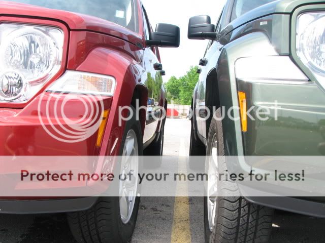

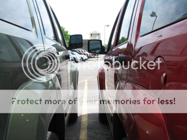

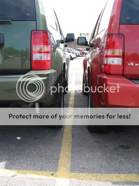

So, of course after installing the Lift Kit, I wanted to go do a side by side comparison to a stock KK. I went to my local Jeep dealer and took the following photos (both KKs are '09 4x4s):
Definitely a noticeable difference, especially in the front half (but more on that in a follow-up posting I'm gonna make).
Anyway, hope this helps anyone considering lifting their KK.
2009 KK Limited 4x4
Coming: :twisted: :JEEPIN:

Since I took my before and after photos in the original post both with stock rims and wheels, below is some quick info on the body lifting:
In the below dimensional info, "Ps"=Passenger's Side and "Ds"=Driver's Side:
1. Front Wheelwell (FWW) increased + 3-1/4" (Ps from 31-3/8" to 34-3/4", Ds from 31-1/8" to 34-1/4")
2. Rear Wheelwell (RWW) increased + 1-1/2" (Ps from 32-1/2" to 34", Ds from 31-7/8" to 33-1/2")
3. Front Roof Rail (FRR) increased + 1-1/2" (Ps from 70-5/8" to 72-1/8", Ds from 69-3/4" to 71-1/4")
4. Rear Roof Rail (RRR) increased + 3/4" (Ps from 71-1/4" to 72", Ds from 70-1/2" to 71-1/4")
I verified the tires had the same air pressure in both the before and after measurements. Tires are the stock Goodyear Wranglers 235/65R17. During these measurements, my KK is 2.5 months old and has 1,880 miles on it.
As you can see, it appears the current JBA 2.5" Lift Kit lifts notably more in the front, which per others with the JBA lift say it should settle some, versus the back. Have others with a JBA lift seen this much lift variance front to back? I would say my lifted KK now sits closer to level and no longer has the "rake" (e.g. nose lower) that it did at stock. Personally, I think I'd like to see the rear lifted a little bit more.
Hope this helps.
