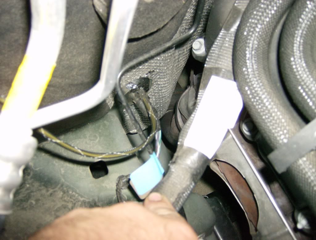

You can see my yellow wire in the black with the white tracer harness just in front of my hand

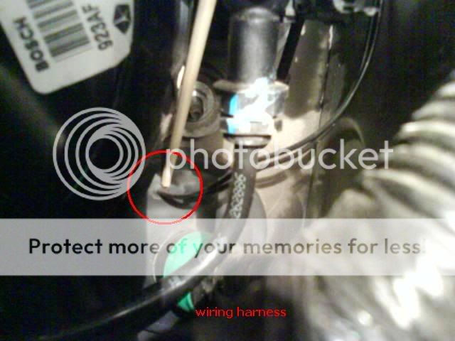

I ran mine threw the grommet, the main wiring harness passes threw, by the steering wheel. It is 2 sided and worked great.
View from the engine compartment, just under the brake booster.

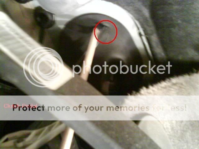

View from the inside next to the clutch pedal. Just above and to the left is the other one mentioned by Boblemoche.
I uses an awl to poke a small hole and pressed the wires threw.

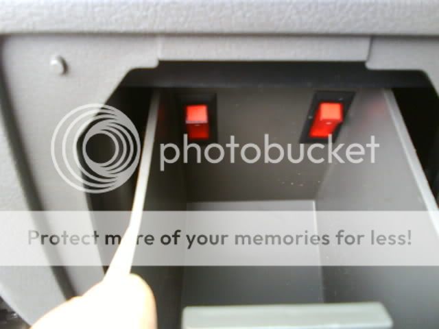

Then I put the switches in the little compartment on the dash to the left of the steering wheel.
ESP Off Switch

Slick trick with the switches, Scar0.
Thanks, I can be clumsy sometimes. This way I won't accidentally turn them on while on the road. lol
