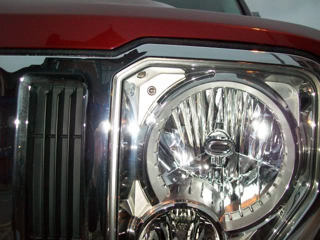

PostPosted: Mon May 25, 2009 12:16 am
See the LED in the upper left corner of the housing
The brochure shows a strip of leds, this is only ONE LED.......
are you sure they go in there?
PostPosted: Mon May 25, 2009 2:04 am
Thats the factory installed DRL.....I don't have a clue as to where the strip would be mounted..... Guess I'll have to do a little more digging
PostPosted: Mon May 25, 2009 2:11 am
Ok if you look at picture B, you will see the extra DRL's at the corner of the bottom valance
