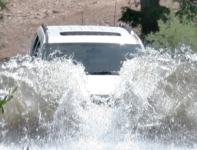

PostPosted: Thu Aug 20, 2009 7:48 pm
Joined: Thu Jun 04, 2009 12:13 am
Posts: 23
I think I should of taken this a bit slower...
But then again only issue was the front plate.
