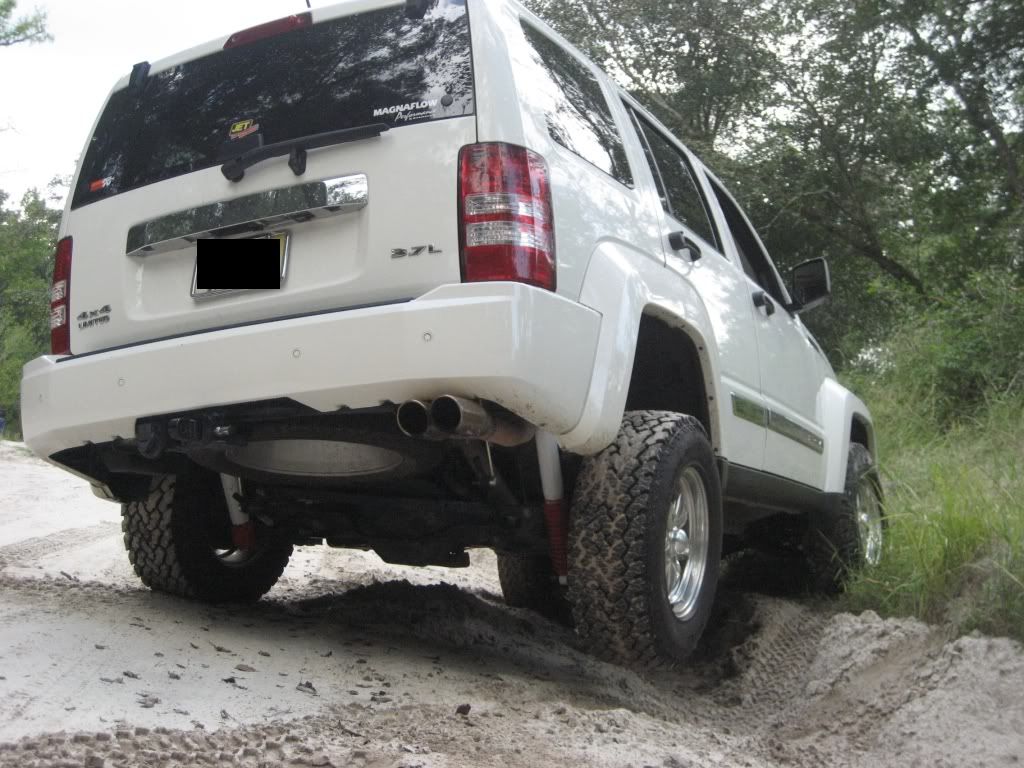

Well your in luck, I'm about to head outside and install my Rock Krawler kit. The kit consist of new (longer) front strut forks and spacers for the rear. If you look at your front suspension the strut forks connect the spring/shock assembly to the lower control arm. Doing the "budget" lift this way takes stress of the front shocks. By adding a spacer to the front springs you add stress to the shock by having it travel more then it was designed to. That is why they recommend extended rear shocks. I got Skyjacker shocks for the rear. Part number H7071, they are the shocks that JBA used to use in their 4" kit. I believe he now uses Bilstein.
Here is a pic of my setup.

Well, its DONE!
Here is a sneek peak ... more pics and info to follow.

You sure you got those rear shocks facing the correct way? Most are the other way around(not all).

I got the shock from Digger, he told me to mount them piston down ...
^^^Ditto^^^ It is stamped on the shocks with an arrow which way they go. My Cummins shocks are inverted but they are Blistiens.

I didn't see any arrows on them but I'll check again ... Digger has Bilsten's on his now and he has them inverted. When I asked him about these he said "I would mount it down. I had them mounted up at one point, but was told that it was wrong. (<-- this is in reference to my Skyjacker shocks) Also on the bilsteins, they say mount it that way"
I'll check for an arrow that shows which way to mount them.
