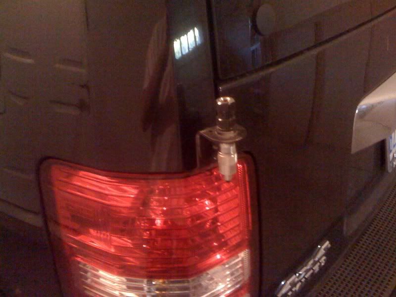

I have been about 1/2 done with a tech writeup for
this for about 2 weeks now but just
haven't had time to finish it
I'll post a picture though tonight.
FYI it is the firestik doorjam mount used in the
left taillight instead of a doorjam.
Works great but it would catch fewer trees
if it was nearer the center of the jeep.
2009 Black Limited 4x4 KK / Mopar Tow Hitch, Tow Hooks, and Skids / Rock Lizard Skinks Super Sliders / Rocky Road Adventure Rack / Firestik CB Antenna mounted to Taillight

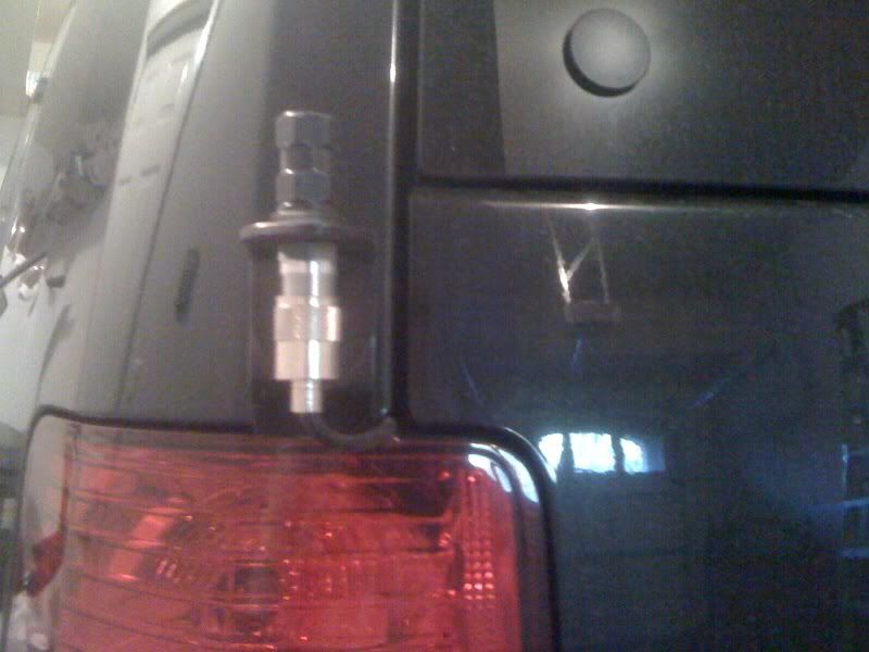

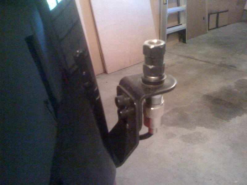

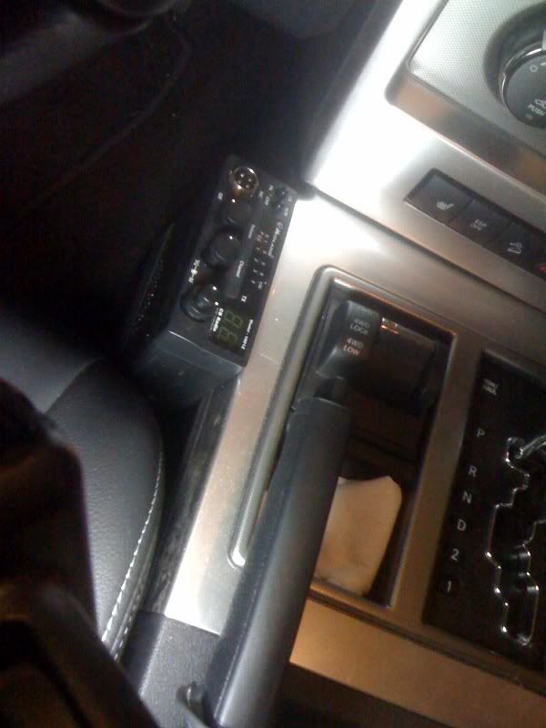

Here are a few pics. Let me know if you have any questions.
I did the radio install in a hurry so it is not actually attached to anything. Just held in by the handy strap.
Sorry about the dark photos. I'll take more in the daytime if needed.

I just got a CB for christmas and was looking at doing this same set-up for the antenna. Does anyone have any input on this? I don't the antenna smacking against my Jeep from driving around so I was thinking of doing a FireFly with a heavy-duty spring, or would a bigger Firestik work better in that case? I took a measuring tape and it looks like a 3-ft antenna + spring will give it enough clearance over the top of the Jeep.
Also I looked around and it doesn't look like a writeup was done for this other then the 3 pictures wolverine snapped. It doesn't look too difficult but I'd like to figure out what's needed for getting the antenna grounded/what holes are needed to drill.

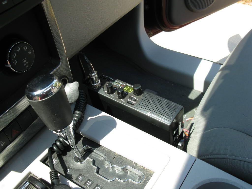

I mounted my CB on the passenger side of transmission. Allows me to view dials and lables right side up and doesn't take away from my leg room. Don't have front seat passengers too often so I don't worry about thier leg room. The speaker is mounted on CB's face so I don't have to worry that trans hump dampening the sound. I use a magnetic mount Little Will antenna. Good for highway use and removal so as not to advertise five finger discount electronics inside. :ROTFL: Aweful if you are trying to dodge tree branches and low garage clearance. :dizzy: Taillight mount would be better if overhead clearance is important. I use aux plug for power. CB mounted so I can easily remove if needed.
08 Liberty Sport,Red Rock

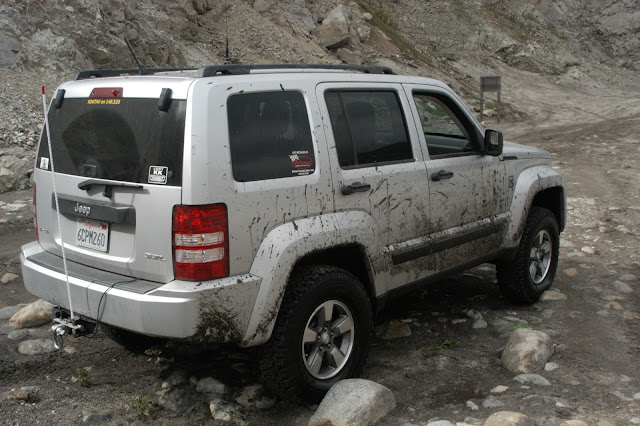

Well I mounted my annt in the rear. It works pretty good for a cb, my ham annt and radio work great! 1000x better and that is no lie
PICTURES OF MY RIG

Location: Central MA
Mine is set up pretty much exactly like DoubleK's above me. That elastic (meant for a map/newspaper?) is perfect for holding the cb in. My husband has much bigger cb in his Dodge 2500 with the big bug antennas in the front on either side of the hood. A little loud for me, but the power is nice to have sometimes. I like the tail light mount above but I'd like to know too if that is whacking up against the Jeep?
Can you actually talk to anyone ahead of you with that set up?
Should have at least half of it above the roof line to work right
