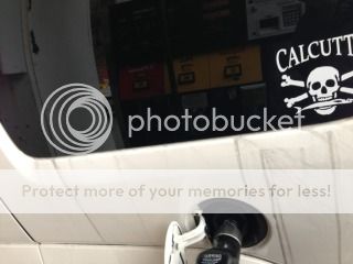

Maybe some of you guys can help me out with this one, the back side window is leaving black streaks all over the side of my jeep. It has happened ever since i owned the car and I finally can't take it anymore. The window doesn't leak from the inside and according the the dealership there is no seal behind that window so id doubt that would be the culprit. im tempted to pop out the window and see whats back there but I dont want to cause it to leak inside. Just thought id see if any of you have experienced similar issues and if you know of a fix.

Are your windows tinted? Maybe it has something to do with that? Just throwing that out there. It's also very strange if it's only happening to one side of the Jeep. Does it wipe off easily?

its the rear quarter panel window which was factory tinted, the stuff wipes off without a problem, I have a feeling its the glue holding the window in place, I called a glass shop and they want 90 bucks to take it out and re-glue, seems like a rip off to me, did some research on how to remove the glass which seems pretty simple, the glue would be the main issue because i believe it needs to be applied hot using a special giant urethane hot glue gun.

I think you should figure out for sure what it is before you tackle it, but if you can do it yourself for less than 90 bucks, you should. I would think the glue would be clear, and not black, but I'm sure it's all fancy stuff for this kind of application which changes everything. Don't understand why glue would be running like that. :?

I'm pretty sure its the same black adhesive that they use for the windshield. They may just have had a badly admixed/expired batch that starts to break down when it gets water on it. It's best to let a pro do it with the right tools and practice. Shop around for the best price but if you do it yourself and break that glass, the $90 will seem like a bargain.
Or you can McGuyver it by cleaning that groove as best as you can with some acetone and q-tips and then fill the gap with clear RTV to seal the water out and the black crud in.

I do clean the roof, but that's not the issue, its coming straight from that window and no where else, it has to be the glue deteriorating i just want to get it fixed before it starts to leak.

Those 1/4 windows are glued in with windshield urathane,yes it's black and yes it will make a mess and next to impossible to get off your hands.Without the correct tools you will be hating life trying to cut it out(piano wire and such are not the correct tools),properly cured that stuff is very touch to cut.
