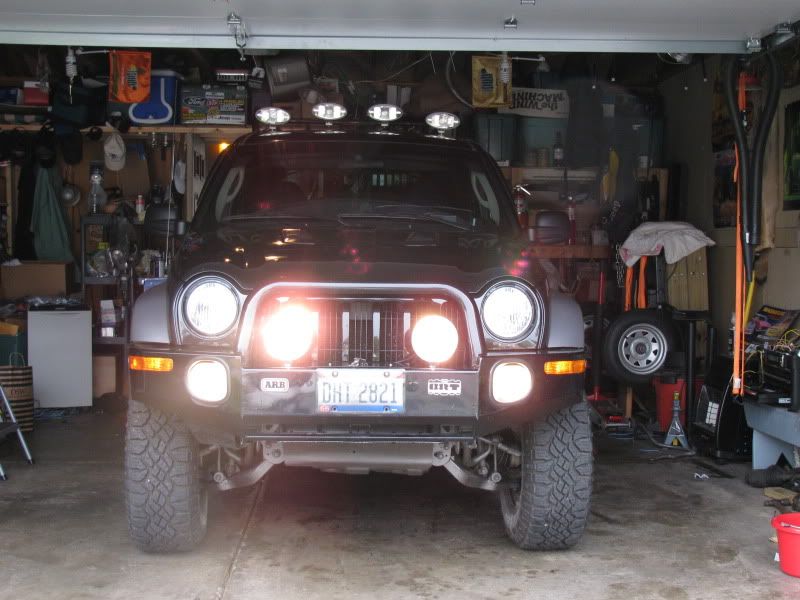

Two spots in the center with a wider beam on the sides works well, wire the insides together and the outsides so you won't have to run all 4 at once if you don't want to
Not the best pic but her's mine wired that way, outer ones are aimed slightly out so you get good side of the road lighting
