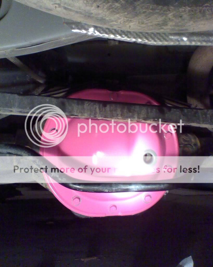

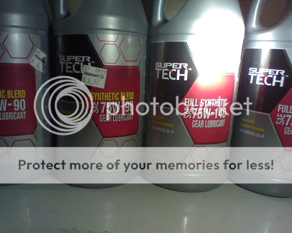

Glad I found this thread because I screwed up.I was changing my rear diff oil and decided to paint the cover. While waiting for the paint to dry(Finally put it in the oven) I decided to change the front.Grabbed the gear lube and filled the front, with the lube I had out for the rear.75-140 so I put it in both the front and rear.

is that Pepto-Bismol pink?

Watermelon, and no you wouldn't understand. :-)r

Painting the diff cover isn't new, but I have to admit, I've never seen one painted "watermelon". Kudos for the originality. What about putting some little black seeds on it? :D

Had to repaint it because I used brake parts cleaner on it and removed some of the paint.
So I used watermelon,and at Church I was told it looks like a baboon butt. :shock:
But I like it.
