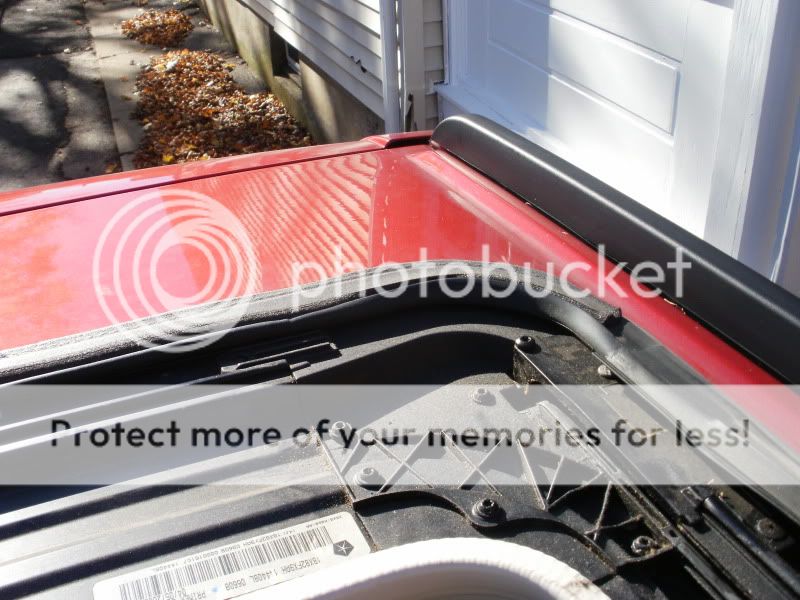

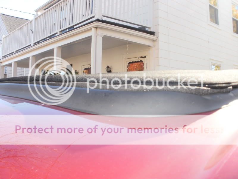

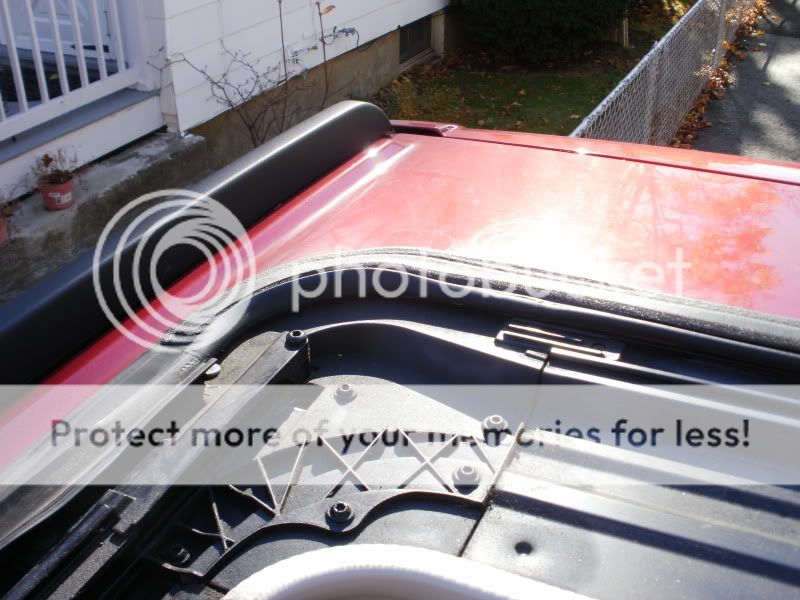

All credit for these photos goes to FDez of course - but here they are:
View from outside, directly at the front:
Top down:
Front Drivers side:
Front Passenger side:
Rear Drivers side:
Rear Passenger side:
I hope to get these done in the next couple days for my own
GREAT job FDez (and whoever it was on Jeepforum if you're here too)

Thanks for posting those Brendon. It is much easier to understand with pics. I had trouble myself before it was explained in detail to me. Around the corners there are lines in the existing weatherstripping (I guess where they glued the curved and straight pieces together). That is the reference point I used to stop. Seemed easier. The guy who explained it to me said not to do the straight parts. I guess maybe because it could interfere with the rails.
If you buy a 10' roll you will have plenty to do the top plus about 3' left over. The kind I used was Frost King from Lowe's but any kind will work. Looking at it in the store I thought it looked too thick and almost went with a thinner size but the 7/16" works great. A smaller thickness may work and possibly be less visible when the roof is closed but I'm not sure about that. That stuff is so cheap it wouldn't be too expensive for someone to give it a shot though. Just make sure you clean the existing rubber strip well. I used rubbing alcohol and was amazed at how much dirt I took off of it.
Good luck to everyone with the Skyslider. That noise was the only thing I hated about it and I was going to be looking at ways to trade it in before I did this it was so annoying. Now the only thing I hate about having the Skyslider is I won't be able to open it for 6 months living in the hell that is New England winter. :furious:
