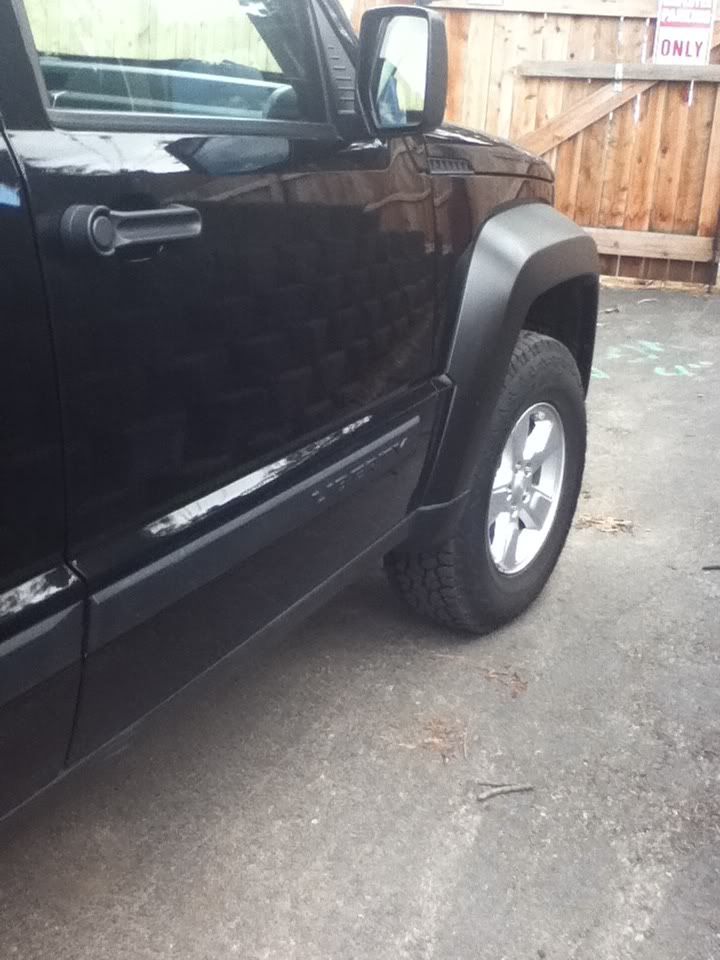

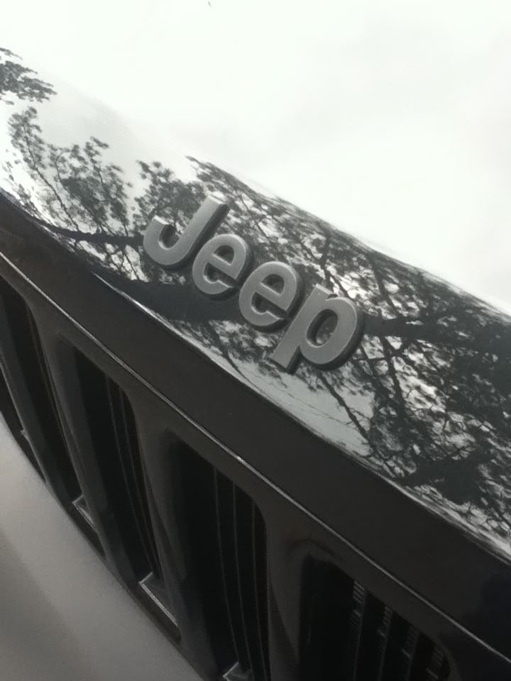

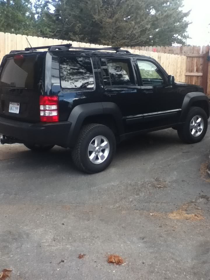

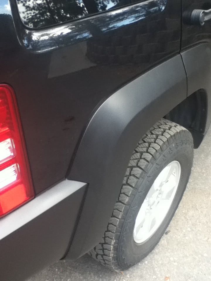

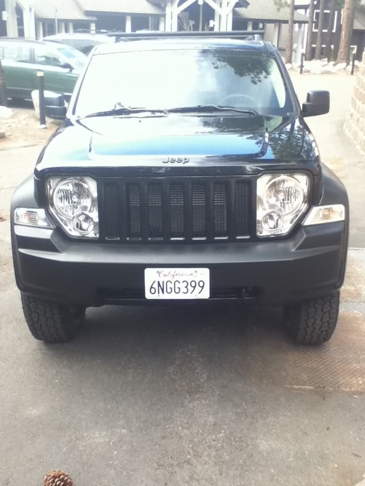

Went ahead and gave myself some matte black renegade style flares and bumpers the other day with spray on plastidip i bought from lowes. The badges also fell victim to plastidip. I love this stuff. There is no sanding or priming and it can be peeled off like a sticker without any residue!
Before anyone flames me: I know it wont last forever and yes it will easily get knicked by tree branches on the trail. I did it as a fun project and it cost about $19 so i wont really care when I have to peel it off.
Pics:

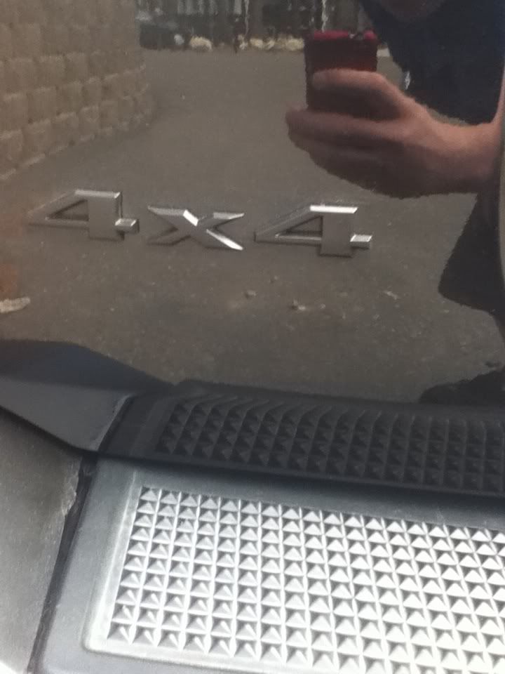

How did you get all the badges off? or did you spray them while they were on the jeep?

This isn't me, but the badges go like this: http://m.youtube.com/watch?desktop_uri= ... 0ma4&gl=US

Update: Its been over two weeks since i did this and been through two snow storms (yes, snow), rain, and one trail. Its holding up like a champ, no fading, cracking, or peeling.

It still looks like the day i did it. I took the time to prep it with a lot of tape and paper. When you are ready to peel the tape you must take a razor and lightly and carefully score the edges or it will all peel off when you pull the tape. Plastidip comes in a spray can too, i bought it for like $6 a can at lowes, i got away with using 3 cans but wish i had like 5. Save some for touch ups later down the road. I haven't peeled any off so i don't know if any redisue or stickyness is left behind afterwards.
