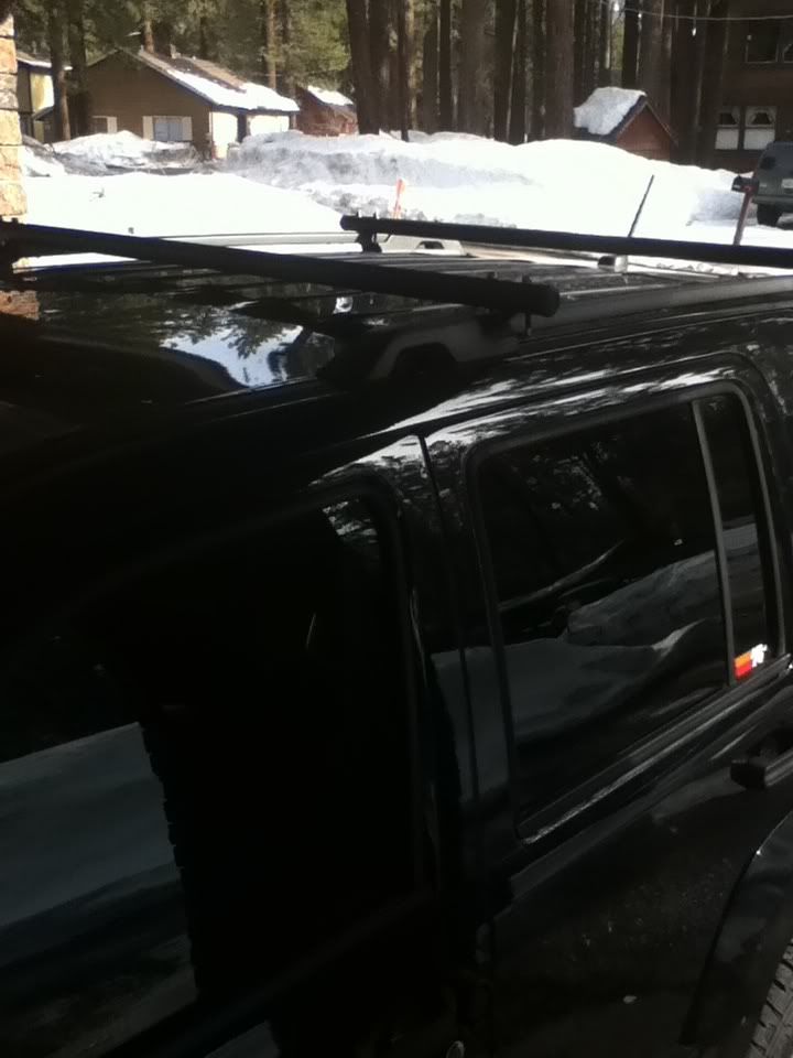

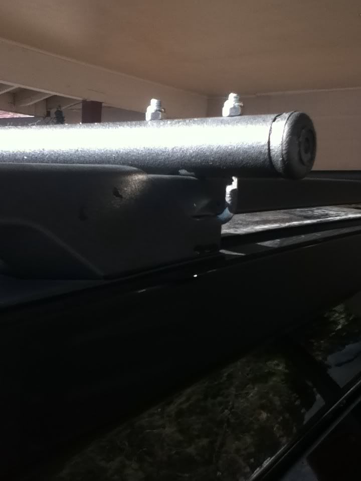

1 1/4" conduit, spray on bedliner, square u bolts, lock nuts, pieces of rubber to isolate from factory bars, and cane ends as caps. Prime and paint after bedliner. $30 -$40. They work good.
