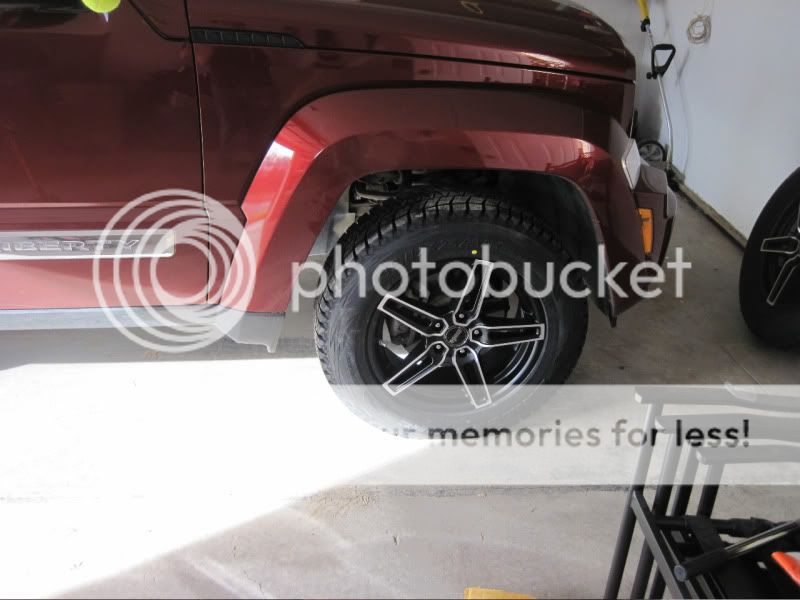

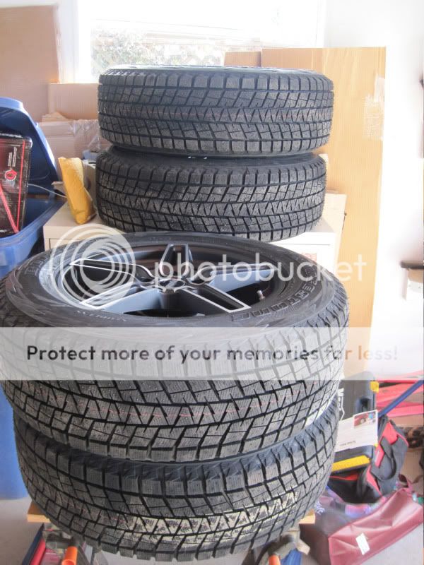

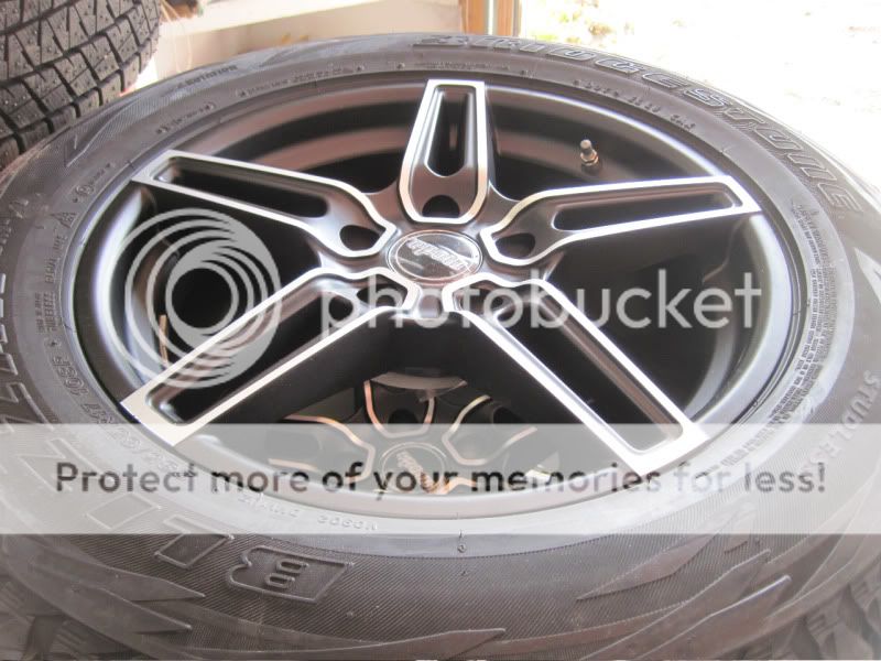

And because people here are picture happy:

(and the photos show wheel/tire package - what part of that is a centering ring?????)

Looks like a thin metal ring
