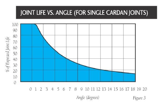

Not based off of anything with real proof but over the years working in the automotive feild and personal experiance expect to loose I'd say about 15%-20% life for every inch you go up without correcting the angles like ball joints,tie rod ends,u-joints,and CV joints.
Over on Pirate they have a graph in the tech section from Spicer that shows how fast u-joints degrade at more exteme angles.
Uhhhhh that's a tough way of thinking:
Let's say that the parts were designed for a life tieme of 100'000km (62'136miles)
=> In case of a a 4" lift, this would give a worst case of approx.: -80% which are 20'000km/12'500miles; one years milage
=> In case of a a 3" lift, this would give a worst case of approx.: -60% which are 40'000km/24'800miles; two years milage
