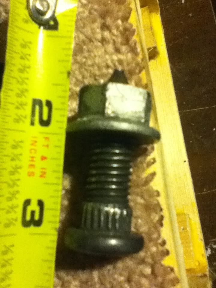

I'll be darned, I think it will work. I'll assume Marlin measured the exposed stud threads while mounted to the oem top plate and going through the kk's body, because there are actually about 1 1/8" of threads (1/8" body sheet metal). With like one half of a thread exposed, you probably can get two 1/4" plates in there. Thats really pushing it though. I'd do a clevis lift and one 3/8" shim if it were me.
This is a top plate mounting stud from a 2010 kk. The nut is 1/2" tall.

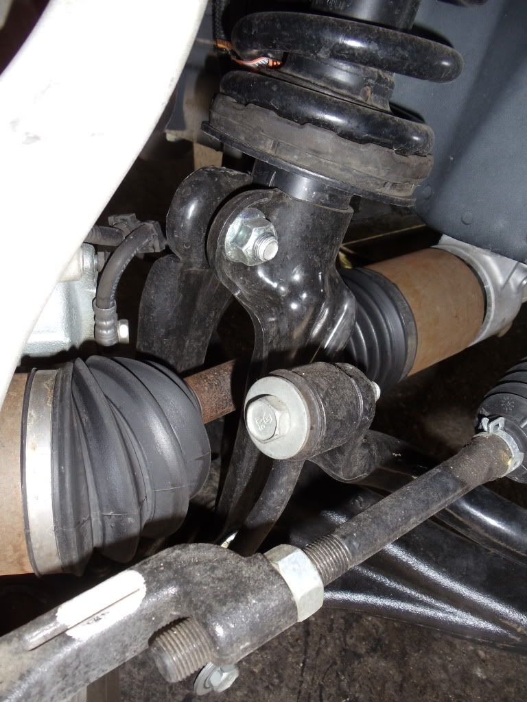

On a kk factory front shock, 2" conduit nuts will slide over both the vertical alignment ridge and the horizontal ridge (where the top part of the clevis fork rests). I think 4 per side in this case would make a 1/4" gap for 1/2" of clevis lift (+1/4" top plate = 1" of lift). Here are pics that hopefully explain:
Note: what i just said goes out the door if using bilsteins because they are a little different than stockers in that area.
