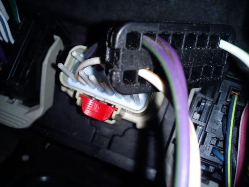

So ive been at this a few hours and its. Getting dark. Im stuck on step 11 of the mopar install guide for kk fog lights. There r these white sticks coming out of where I need to plug the two wires into. I have pix if that will help. I just don't get what I'm supposed to do.
Also am I supposed to take connection d out of the fusebox? It doesn't budge.

did you pull up on that red tab? You might have to use a flat head screw driver.

Yeah
looks like you disassembled the plug instead of removing it.

After 2 hours I ended up getting it. U had to push the red tab up to reveal a small button. Then press it in and pull. Then U had to use a dental tool to like pick at the plastic end cap to move the rubber gasket thing that holds the white things in place. But after All this work I realized that the headlights he shipped me were broken. Apparently he didn't understand u have to bubble wrap the WHOLE light, not just the lens. The mounting brackets were in shattered pieces in the box. Hopefully he just replaces it :evil:
