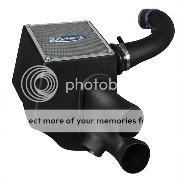

To start Volant does NOT make a cold air intake that is made to fit the Liberty's BUT they just came out with an intake that fits the 3.7 Dodge Nitro!
I wanted to do something different so I bought it and installed it. It fits 95% perfect. The only major change I had to make was to extend the intake sensor wires because the location is different and the factory wires are short. Other then that it's pretty straight forward. I've already contact Volant about my install and sent them picture and info on some minor changes that would need to be made to make it 100% perfect fit. Maybe if we can show some interest here they would go forward and make the changes and produce the intake designed for us.
Here are my pictures.

Looks good, what did you do to extend the wires? did you cut them or make a connector that will plug into it? This just got added to my to do list.

I just cut the wires and adde about 5 inches to them. I'm waiting to hear back from Volant to see if there is any interest from them in making one for the Liberty.
bily O wrote:
no intrest here, it wont outflow the factory intake! altough it looks great
And why won't it outflow the factory intake? Just the fact that this uses a smooth intake tube instead of a ribbed tube like the factory box is improvement enough. Not to mention the PowerCore intake filter has a better flow rate then the factory filter ... So again, why won't it outflow the factory box?

What you are describing is a COLD air intake. Ram air intakes are very short and leave the filter under the engine bay. They are called "Ram" air intakes because of the short run and the "Ramming" of the air quickly into the throttle body. Once you extend that to receive cold outside the engine bay air its considered cold air intake.
If you read the "Features" of that Kenne Bell intake "Picks up only rammed cold air from bumper." They are trying to make 2 different style intakes into one.
Personally I think the design of the Kenne Bell intake isn't very good because the filter element is right next to the engine and will heat up as the engine heats up. Yes you will be pulling in cold air ONCE YOU START MOVING but when you are sitting at the line and during take off you are sucking in HOT air. Also the tubing that is "ramming the cold air" into the engine is corrugated, corrugated tubing has a lot of resistance verses a smooth wall plastic tube. Also the corrugated tubing is very thin and will heat up faster then an 1/8" thick plastic tube.
The design of the Volant intake moves the filter away from the engine, lowering the intake temperature and then has a tube running from the intake box to the outside of the engine bay which is where it sucks the air from.

the Kenny Bell kit dosent include the tube from the throttle body to the filter box. the drawbacks are they will suck up leaves, water and small animals that will choke out the engine, better to keep the intake up higher in a jeep i guess.
Volant makes a very nice kit, you should see if they will make one with a snorkel.

The difference is the Volant has 3 fresh air "in" ports (2 forward and one in the wheel well) VS the stock box which only has 1, which has two 90° bends in it.
Doesn't matter if 3-5 or 19 holes
The stock air box is designed to give the 3.7 all the air it needs.
Now if you have different cams, headers, exhaust , computer internally reflashed then it maybe able to use more air.
Without those things being done, would not be any benefit really
