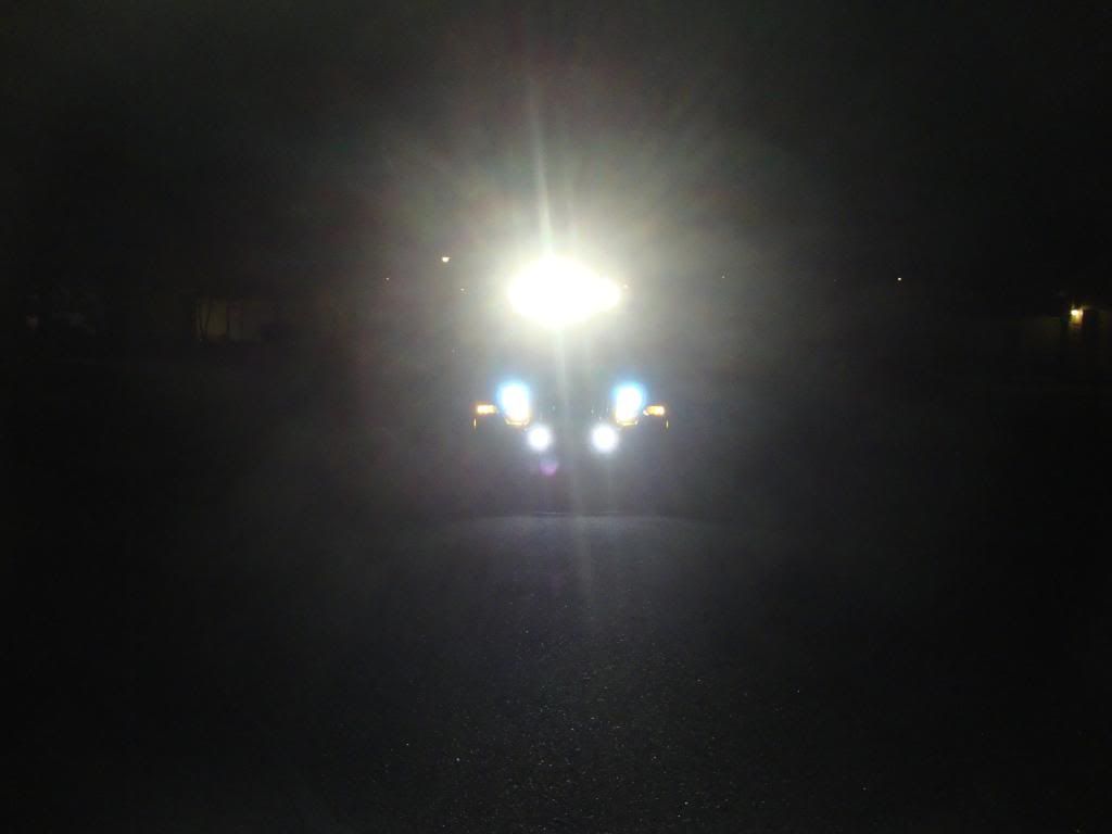

Add more lights :twisted:

I had no idea they made HID's that don't have a high beam. Any particular HID kit I should look into? And thanks Digger for that pic lol. Instead of buying a new light kit I'm just gonna have u drive in front of me and light up the whole street. :-)r

I light up mountain sides :twisted:
DAYUMMMMMM :rockon:

musclezmarinara wrote:
DAYUMMMMMM :rockon:
Wait for the next pic I take. I changed out the bulbs in my bumper lights to the new PIAA yellow ION bulbs. They are 55 watts each but look like they are 85's
