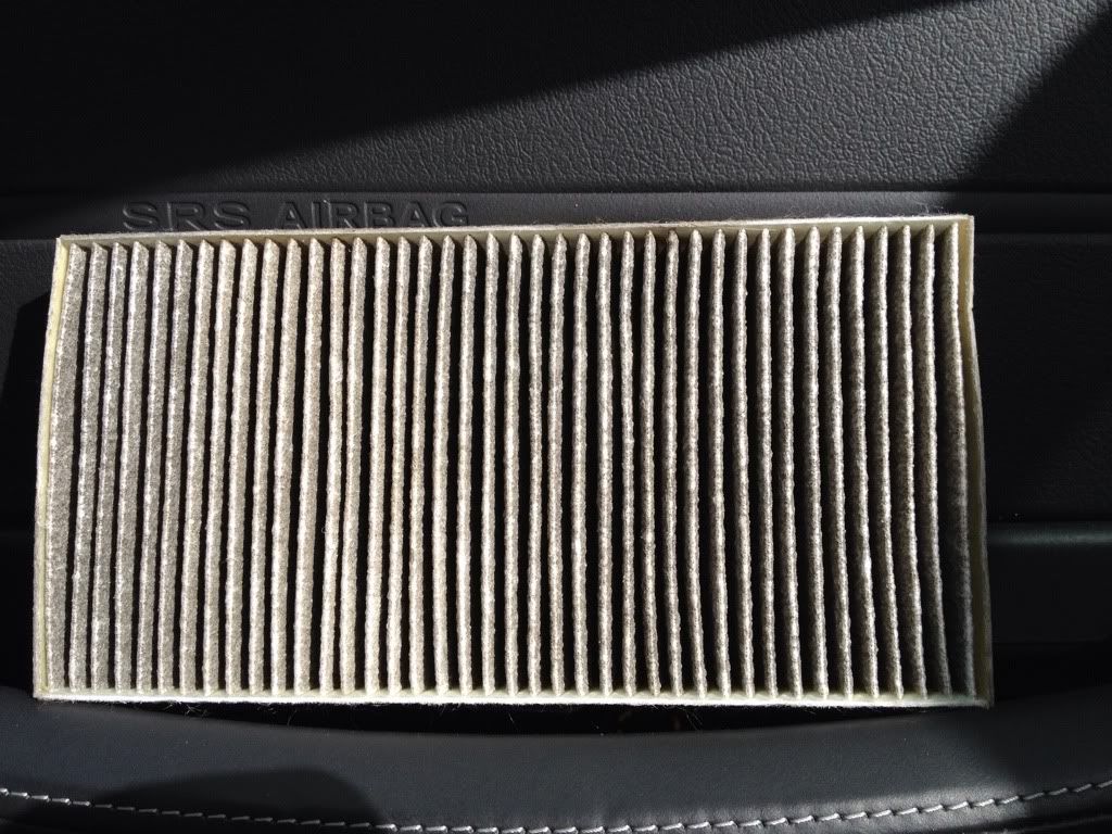

I now have 1 Jeep and 1 Ion both have Cabin Airfilters.
The Jeeps just turned 24K miles, so I replaced the Cabin Airfilter.
The Ion just turned 100K miles and I for the first time replaced the cabin Airfilter.
I learned that after 100K mile of stuff plugging up that filter, we lost 40% of our airflow in the car...
It also did not look much worse than the Jeep's....
So preplace them often.... Do not wait 100K miles trust me on this...
All stock Auto with 235/60/18

just replaced mine at 28k miles and they were black. Now the air flow is a lot stronger. Don't wait you can notice the difference right away. Only takes a min to chech how they look. Buy online not at the dealer as they are double the coins there.

For those who are new to this, like my self.
The parts can be order online from many places. find the cheapest or the one you like the most.
The pack comes with 2 filters... For a good reason.
Note.. You need to use both.. the second one is behind the first one and not easy to see or get out...
Jeep you are a fail on this... Why not just make 1 large one??
Sometimes I wonder who gets these type of things approved..
I would go into a huge rant, but there is no point...
