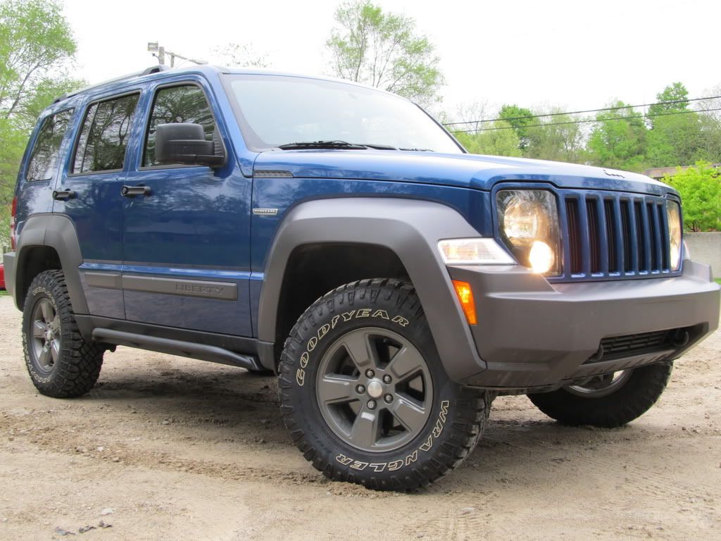

Can't argue with the looks, Marlon_JBT! It makes a huge difference. They really should have offered a mild lift option from the factory.
