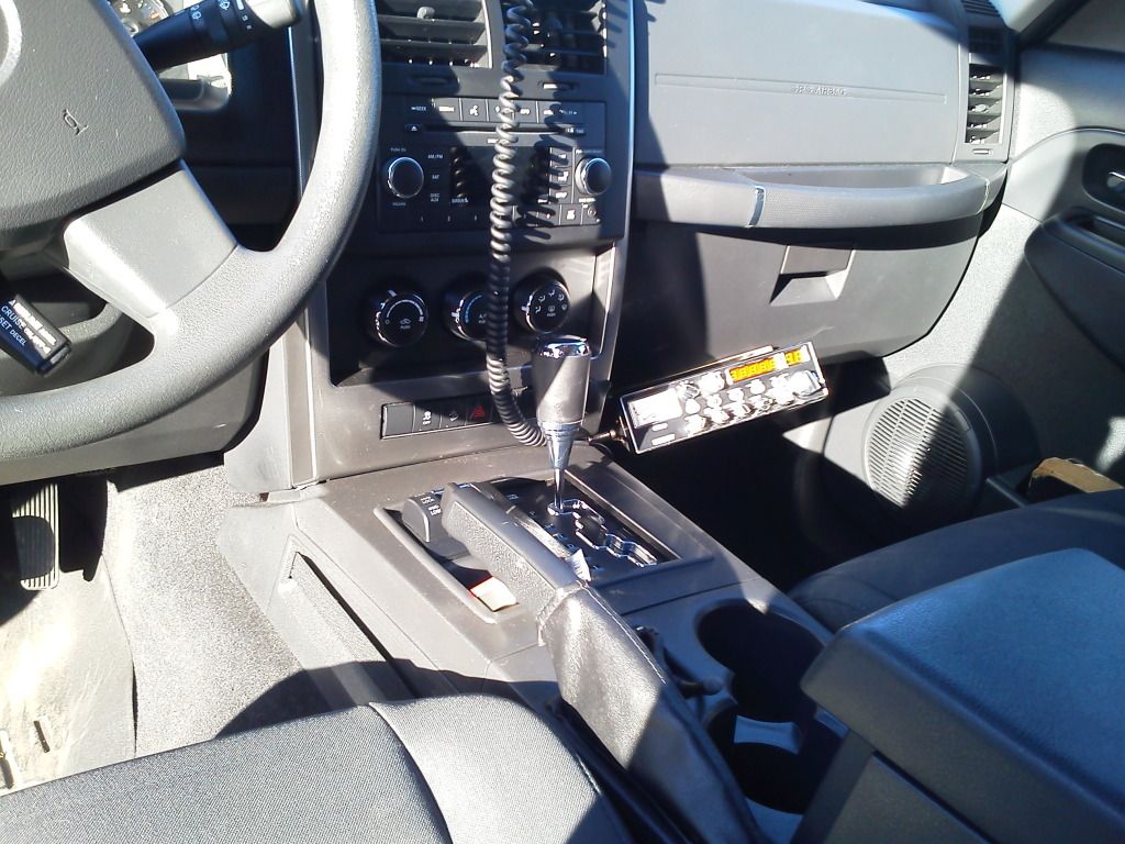

First I ran the cb's power wire through the rubber grommet found on the firewall on the driver's side into the footwell area, then behind the vertical center console over to the passenger footwell area. (Sorry no pics of this) I crimped eyelets on the ends of the cb power wire and hard wired it in (not the battery but the closest hot post in the black power center between the battery and the firewall).
Now mount your radio, I screwed the mount bracket onto the glove box but tilted toward me so I can see it better from the driver's seat.

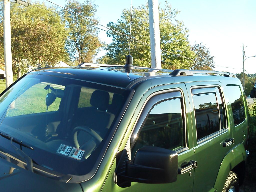

And here's a pic of the magnet mount. Not the most practical height if you'll be doing any off roading but I want transmit/receive distance. :frankie: My mic hanging from the rearview can be seen here. I used a mic hook that can be found at your nearest truck stop.
I'm 8' 9" to the 360 ball of the whip!!! The good news is that the Wilson 5000 comes with a weather cap so when you unscrew the whip you can cap the base to keep water and debris out.
I can't duck under anything but this is my work vehicle. It's basically a pavement princess and doesn't see any off roading. With the 62" whip I'll be walking the dog and kicking the cat though! :seuss: I'm hearing people in Arizona, California, Florida, and Texas. 8) I talk to other drivers 6 miles away easily and can always open up the squelch to hear someone in the distance.

I guess you don't have many passengers? Looks like it would be pretty uncomfortable if you were to be a passenger in that seat. But it does look nice.
 Post subject: Re: CB Radio Install
PostPosted: Mon Sep 24, 2012 9:29 am
Joined: Sat Aug 18, 2012 8:41 am
Posts: 75
Location: southwestern PA
I sat in it after the install, it wasn't bad but yeah I'm the only one in the Jeep. The car seat is in the Patriot so when we go anywhere together we're in that.
