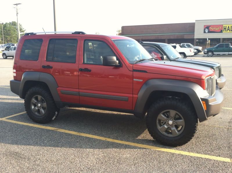

Met up with renegade today for the first time and we went to discount tire direct and got my tires put on. It didn't rub as bad as I thought it was going to. Got about 17.5 highway on cruise at 70. Overall I'm pleased and I'm so so so so glad I went with 265's. I didn't want to have to spend the money on tires twice. Hope you guys like the pictures, will be more to come tomorrow.

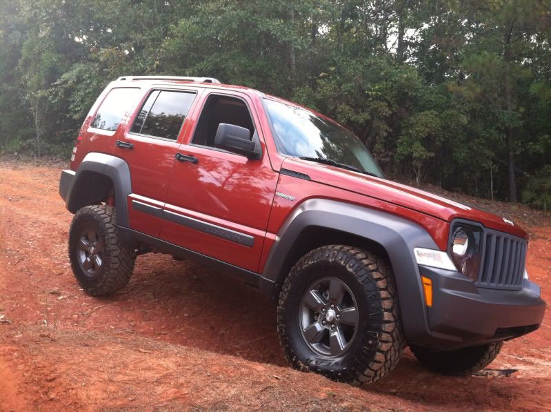

Then of course I had to try them out. Rubbed a little as expected nothing a little fine tuning can't fix.

Lookin good!

Regear to 4.10's and gain back alot of low end power and a few mpg's on the highway.Throw in 4.56's with those tires and you'll have a grin ear to ear.

Are you running spacers?

Looks so awesome. What's your experience with the air dam off?

They look fantastic. I'm glad you posted this thread. Made up my mind what I'm gonna do with tire size after mine need replacing. Any plans on regearing?

The tires look great, but what kind of mileage on the highway did you get before? I get 21-22 ('10 Renegade), I'd hate to drop to 17-18.
And are you telling us what your computer says the mpg's are? This would be off because of the new tires, correct?

IF you regear like you should
then mileage will be brought back to what it was before or close to what it was
Without regearing you'll have loss of mileage, trans always shifting trying to find the right gear, will run hotter etc

Roast tires look awesome, nice a aggressive.

No not running spacers

I took it off so it wouldn't rip off on trails. It drives and feels exactly the same and no notice to change in fuel milage. It's worth removing and at least setting to the side.

I do want to regear and put lockers eventually. And by eventually I mean when I can afford it. To be honest I think the 265's look amazing and I have had nothing but compliments about them. On the other hand i get about 14 or 15 mpg city and 17 or 18 on the highway. I was getting about 18 city and 22 highway prior.
Me personally I couldn't justify buying a set of tires darn near the same size. That's why I went with 265.

Yeah it's about 4mpg off. If I'm cruising about 65 or 66 I'm really going 70. That's all the faster I drove so I don't know if the gap increases with the higher speed
