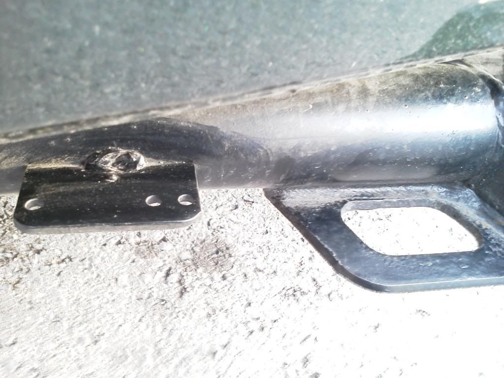

Here's the pigtail receptacle mount. Will I be able to jury rig up someway to mount the Mopar plug to one or more of the three holes?

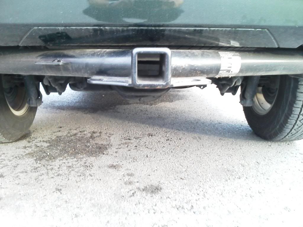

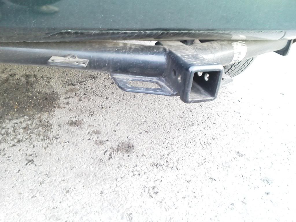

Here's a look at how low the Uhaul hitch sits. They didn't even need to cut out that perforated part on the very bottom of the bumper like the Mopar hitch requires!
