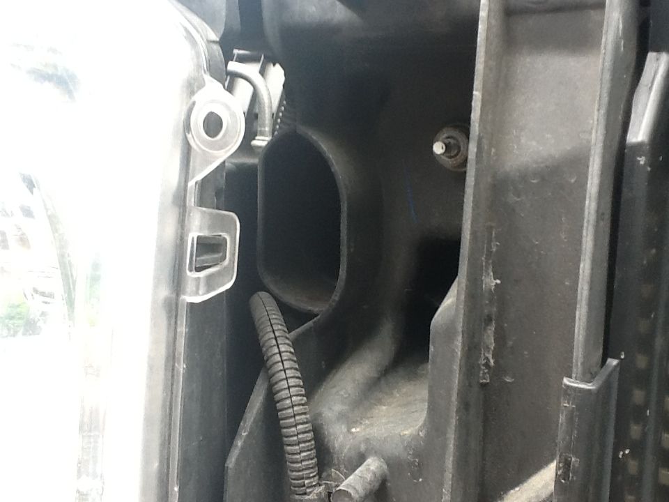

Hello, Jeepers. I'm always under the hood looking for a better design to help us all out. What's the deal with that plastic, oval intake scoop behind, to the side of the passenger headlight? (Better seen with grille off) I don't understand how air can even be coming in at a good rate through there. Any thoughts on improving this, or can someone clarify that this design is just fine?
Photo courtesy of lfhoward.

Your stock airbox outflows what the 3.7 can handle for air.You would be amazed at how much air is pushed through that opening when you above say 40mph.

Thanks, tj. I also have a cold air intake... It just seems like the grille is completely blocking the airflow that I might be able to benefit from. Just trying to improve the engine efficiency if possible. I'm probably on the road to a bored out throttle body in the future to fulfill my needs.

The whole idea for that placement is to get cooler outside air as opposed to the hot air under the hood. Ram air effect would be nice but it is more than the engine can handle anyways. The other important function is that the cold air intake be behind that plate in the grill to shield it from water ingestion during rain or water crossings.

I agree, but that slot of the grille is a solid piece and not open. Seems like they were doing some overkill protecting the engine.
