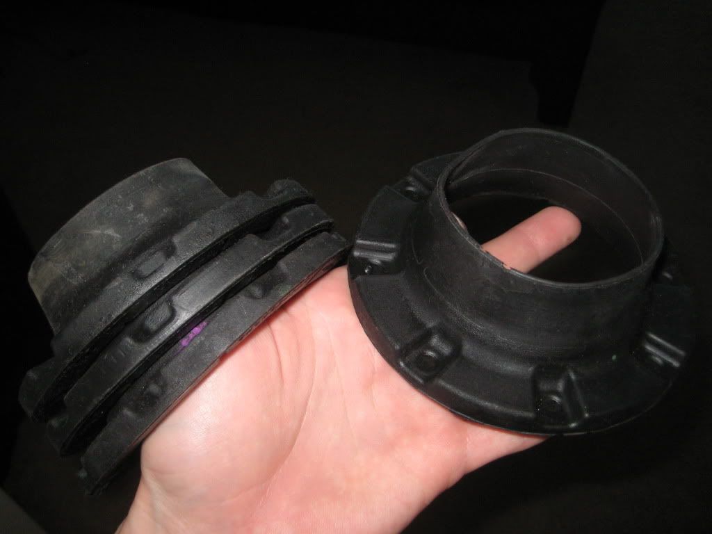

coil spring isolators are the little rubber spacer, on top and bottom of spring. its kind of hard to see in the bottom pic but if youre looking where the springs are mounted you can see the little rubber pad.
you can get a couple spares from jba here http://jeepinbyal.com/prod-Rear_coil_sp ... r-705.aspx

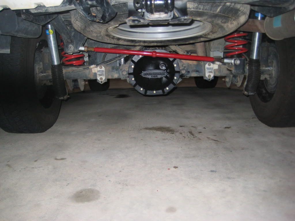

Here is a photo... Sorry it is dark, it was taken toward evening...
This is with a full tank of gas... It leans about the same about before and after the lift...
This photo exaggerates the leaning a little more then on pavement... My driveway is gravel...
On pavement it not so pronounced...
This help your folks better visualize the degree of leaning... Thanks

I can see the coil spring isolators, can these be stacked????

 Post subject: Re: Do all Jeep Liberty's lean towards the driver side?

yes they can be stacked

Got a chance to install the coil spring isolators as suggested. The results are good.
Could maybe use one more, but it is pretty close... Thanks

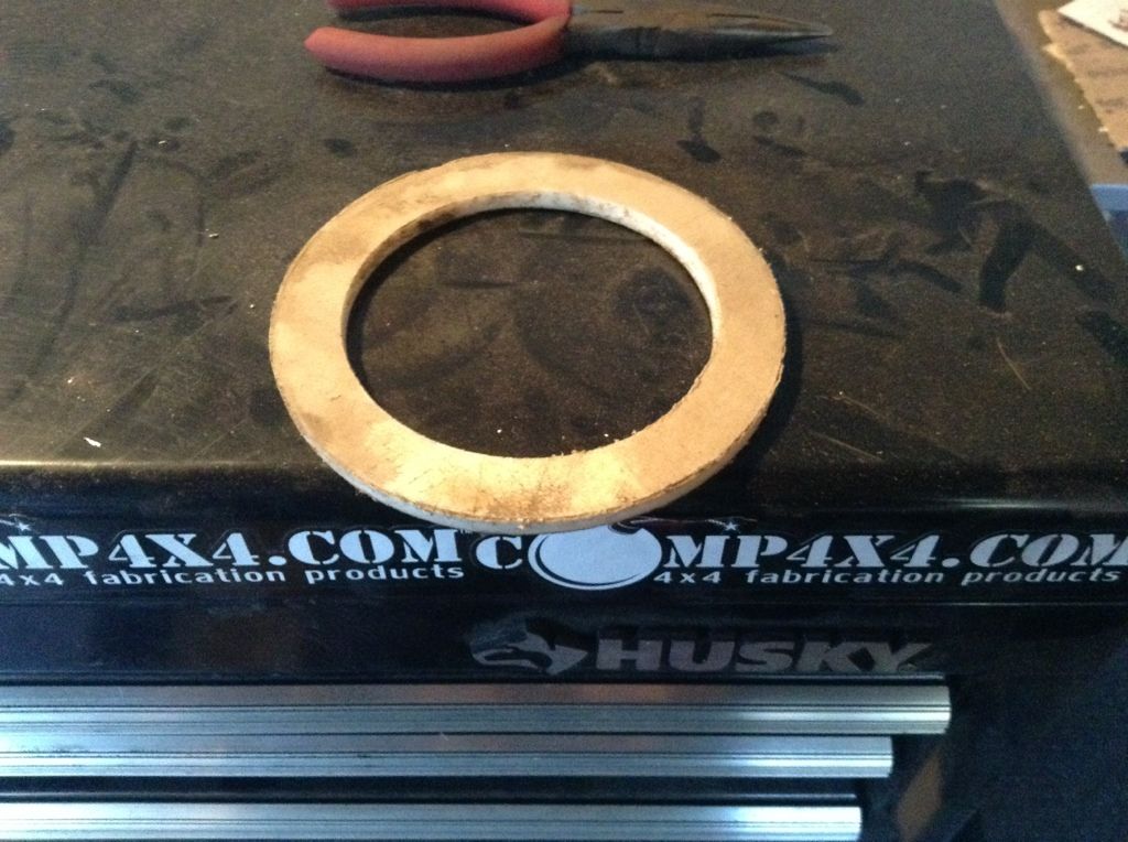

I made my own with hole saws and a cutting board. :JEEPIN:
