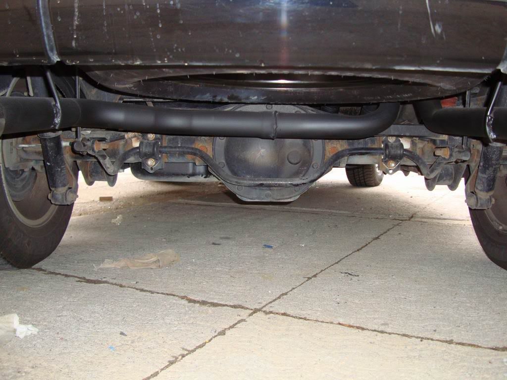

This is how it has been done on a KA. It would work on a KK as well.
The marks on the spare are from weld slag. They did not drop the spare during the install.
I borrowed this Pic from another KA owner. I can link the thread if you like.
That's cool. I didn't think of the KA since they both have a similar structure. I will look deeper into this...
May be you link me the thread so I can show the shop... :POPCORN:
Pretty cool! Scaro, would you mind posting the link? Wouldn't mind reading more. Curious what the exhaust is painted with.

This is the link to the thread.
He ran out the right side stock single into a dual out muffler, then back with 2 pipes.
Not a "true" dual but looks good and sounds great.
A "True dual" would still require a cross-over between the two banks to keep things balanced and allow for the proper scavenging effect to keep things working as they should.
