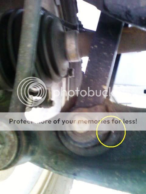

Check the flag bolt on the clevis fork. When I did my lift one of the flags was hitting the lower A-arm. Mine was a squeaking sound, but it could be your click. I just bent it out a little, no more noise.

@Jeepmonkey - we may have the same issue, but I can't really say it sounds like a metal-metal noise nor do I get it on the road reflectors. Mine is a really high-pitched, rapid clicking that spontaneously occurs when turning left under load, and really only at full driver's wheel lock. Took it to the ski trail this weekend and sure enough, on two (out of several) left-sided hairpin ascending turns, the click occured (but not so on any right-sided turns, and never on the descents). The best way to describe my clicking is a combination of rapidly tapping your fingernail on the plastic portion of a computer desktop tower (I'm at work now) with a minor background component of flicking one of those old spring door-stoppers (faint background oscillating noise).
@lfhoward (and everyone else) - I did go ahead and install the extended sway bar links (and a new track bar) - I agree, the handling seems better...abit more nimble, I guess.
For what it's worth, both the primary installer and second-look garage said everything looks set and torqued correctly (and torqued on the ground) - so basically, they're not sure either (but nothing looks like it'll shoot out, explode, or disentegrate while driving...i.e., it 'seems' safe). As was suggested earlier in this thread - maybe it really is just all the electronic gadgetry in the Liberty (my first Jeep with EPS, TC, etc), though I've heard that variously described more as a low-pitched grinding noise; I never noticed any blinking lights when the noise occurs, though I'm abit more preoccupied with the driving then staring at my control panel. When I find the resolution, I'll update. Thanks again all.
