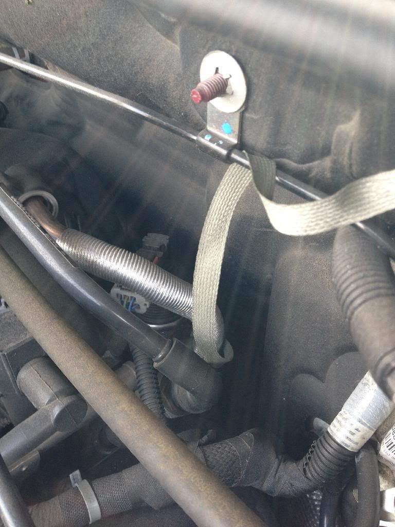

Guys, I found this dangling by the firewall, attached on top with one end
but not attached to anything at the other end.
Can anyone tell me where this thing is supposed to hook up to?
Appreciate the help :)

Been researching that part number, and all it's saying is that it's a chysler/mopar ground strap. I have not found any diagram.
Now I know ground straps are usually attached to a chassis or the engine block...I just want to be sure.

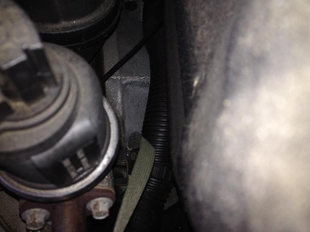

Best I can do for you. It's down by the firewall...
Here's a shot to show where it goes down:
 Post subject: Re: question about oem ground strap
PostPosted: Tue Apr 22, 2014 1:59 pm
Posts: 146
Location: Long Island NY
Cool thanks, so it's attached to the engine block at the rear?
PostPosted: Tue Apr 22, 2014 2:21 pm
I think so. Not gonna lie, the engine was hot and I couldn't really see it. The phone ended up being my eyes.

I think they forgot to put it on at the factory. (it was just hanging down)
The bolt that it goes into, is all the way in the back.
I cant even fit my hand in there. lol
Using a Fluke multi meter, I could tell the engine block is already grounded.
I think this might be an extra ground, as it doesn't seem to affect anything on the KK.
I'm still gonna try to attach it or find an alternate location in the engine block.
