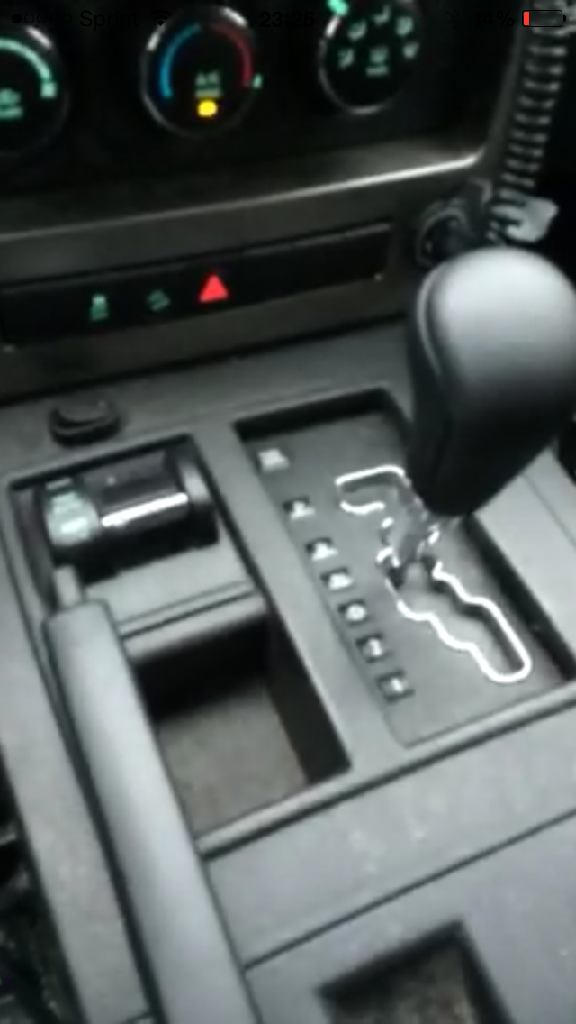

I've been running a Durango shift knob since 2010, dude!
Sorry the picture is so blurry, it's actually a grab from a video that I sent to a fellow LOST member.

WARNING: It does NOT lock down like the stock KK knob BUT it fits VERY snugly. All you gotta do is remove the old knob by prying down on the lower chrome piece, pulling up, and installing the Durango/WK knob by just sliding it on the shifter polethingy. Twist it around until it settles.

Looks very nice.
And I thought I was the only one that uses Neutral.
