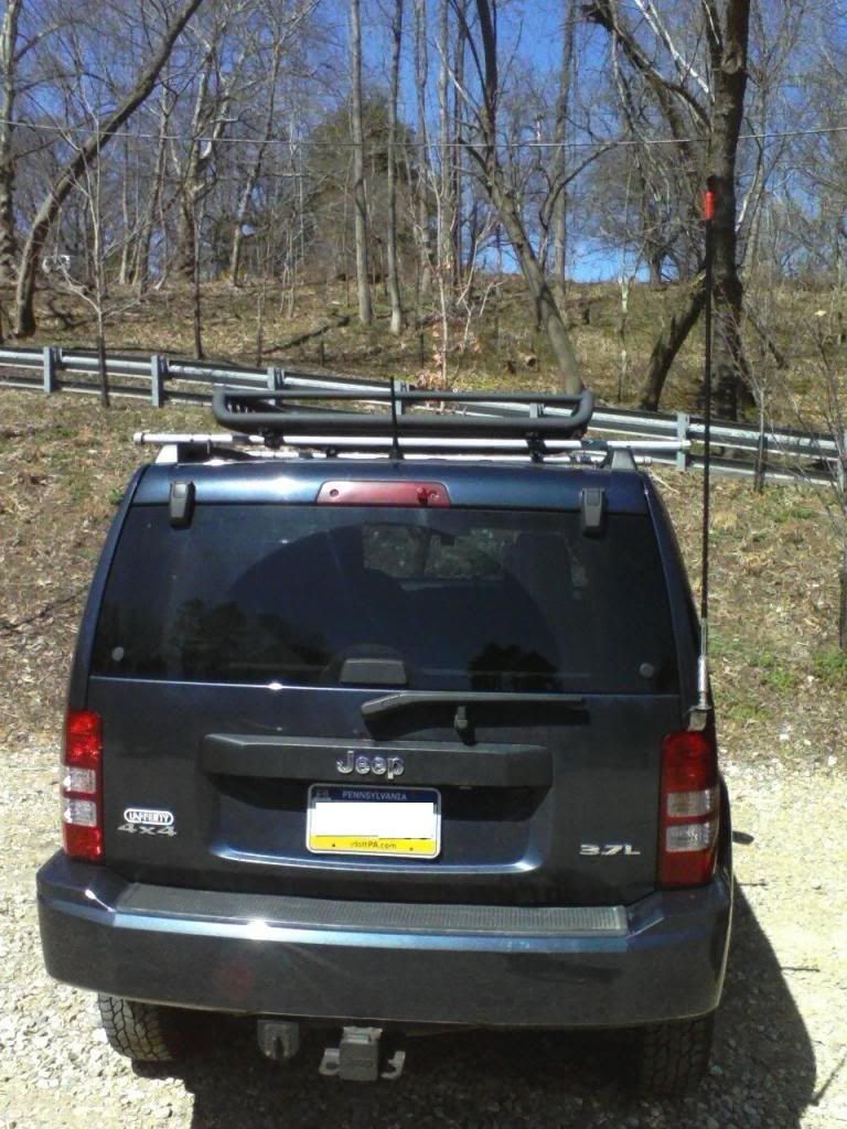

It does work well. I have a jack I mounted on the side of the center console for the CB handset. When I don't want it out, I just disengage the handset and put it inside the armrest. There is a hanger I put on the dash to the right of the instrument cluster to hang the handset when in use.
In terms of the antenna, pictures are better than words. I have a quick disconnect on it, and when I'm not using it it lives in the trunk. It is a 3 footer.

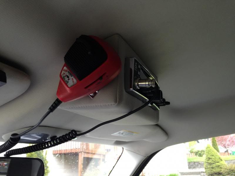

I'm running a cobra 29 LX anniversary edition. Tuned and peaked and love it, though I need to swap out my mic. went with a power mic, but it's just way to much for the tuned cb.
But, here it is in all it's glory.
