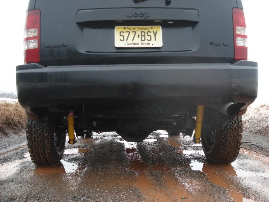

This was like the first week they were installed. I've got about 10K miles on them now. I can take different angle pictures for you if you'd like.
I'm also running 1.25 inch spacers for a wider stance and still no rubbing.

Where are you keeping fifth? Not on the jeep. I didn't see a spare.
 Post subject: Re: 2008 liberty sport and OME lift with stock wheels tire h
PostPosted: Thu Aug 21, 2014 9:48 pm
Eddiebell wrote:
Gageraid wrote:
Eddiebell wrote:
Awesome. SAMs wants 170 a piece. Any better promo codes to be aware of?
That's about what I paid. $192. I bought five. :grim:
Under the rear, where the KK's spare tire is :jester:

That's got to affect clearence. I thought only skinny spares could fit.

Eddiebell wrote:
Gageraid wrote:

did you have to adjust anything?
PostPosted: Fri Aug 22, 2014 12:39 pm
Posts: 3278
Location: Jersey
Not at all. Members have been fitting MUCH larger tires in there.

Ok thanks. I honestly think under the jeep is stupid but well they did it. Wish they did a rear like previous one.
PostPosted: Fri Aug 22, 2014 12:53 pm
Posts: 3278
Location: Jersey
That's what the majority of us think as well.
There's a member here, AtTheHelm who built a fantastic rear tire carrier which he sells if you contact him. He has also built a variety of other things like steel bumpers, roof rails, and a front recovery system.
