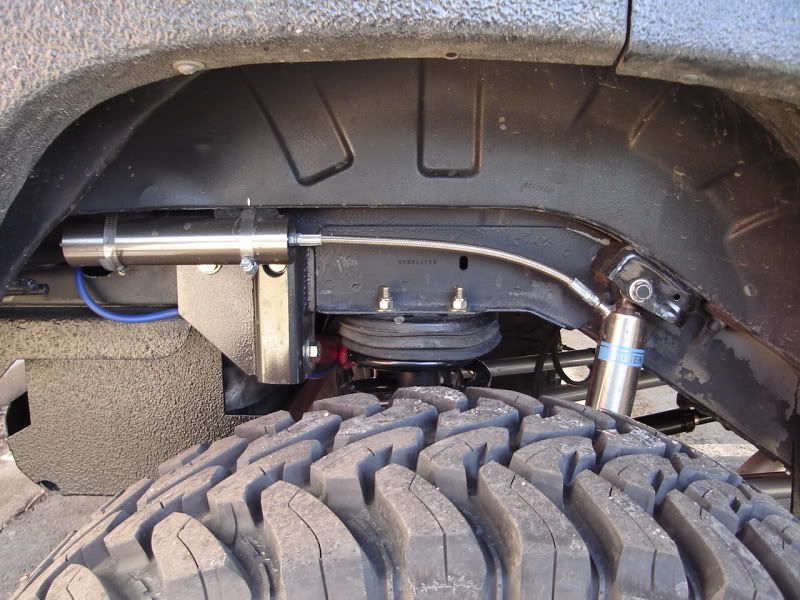

5100 series and below is considered "factory installed" since a lot of vehicles do come with Bilsteins from the factory and the 5100 series is that line.
Like I stated and there instructions state mount so the label(or any stamped lettering) is correct way.
My rear 7100 series....................
