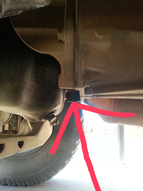

Hey guys. I took my KK out doing some off-road stuff, a little bit of 4x4 testing it out since I bought it. As I was moving around, a buddy noticed some whitish smoke coming from underneath the body. I looked and it was coming out right between the oil pan and transmission as pictured below. As I would revved it, it would pour out and then slow back down again at idle. I checked my levels and they are all good. Also, I am not having any leaks, zero, and I cannot replicate it on the street. I still smell it on start up, a little burning oil smell.. But like I said no leaks. No check engine lights are on and it seems to be running just fine. Any ideas? Thanks.

Wouldn't think much of it if no fluid leaks and good levels. Sometimes cars do funny things without reoccurring again.

Didnt see it was a manual... My bad. Do you ride the clutch off road?

I've been driving stick for a long time but this is my first 4x4. Maybe I did ride it a bit hard and that would explain it I suppose.. If it starts slipping soon then we'll know lol.

Yep. As long as fluid levels go and no drips on the ground i think the clutch is the culprit in this one.

If it's your first time driving stick offroad then it's possible you burned the clutch a little. Did it smell like clutch? Without any leaks it's what I would assume. If you had an auto I'd start thinking about the rear main or other gaskets back there...but you don't.

Sounds like your clutch smoked a little.
Mine did not slip at all, then BOOM!
The clutch disintegrated.
It would have been nice to have had it slip a little before it went. Could have saved me some $$$. When they blow up like mine did, you have to pretty much replace everything.

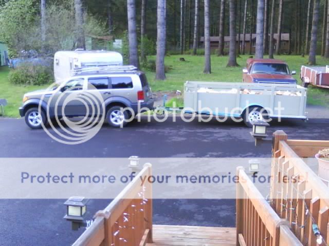

Our boat is a 1989 SeaRay. 4.3L inboard/outboard. 18' long @ 2800 Lbs dry. To get to the lake we have to go up and over a 1200' pass. No issues...
Fire wood trailer 5x12x3. No idea how heavy this load was, but just look at the trailer SQUAT!
The 3.7 tows great, but is not a speed demon. Slow and steady (60 Mph) gets you there.
