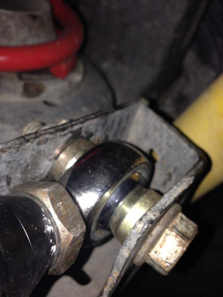

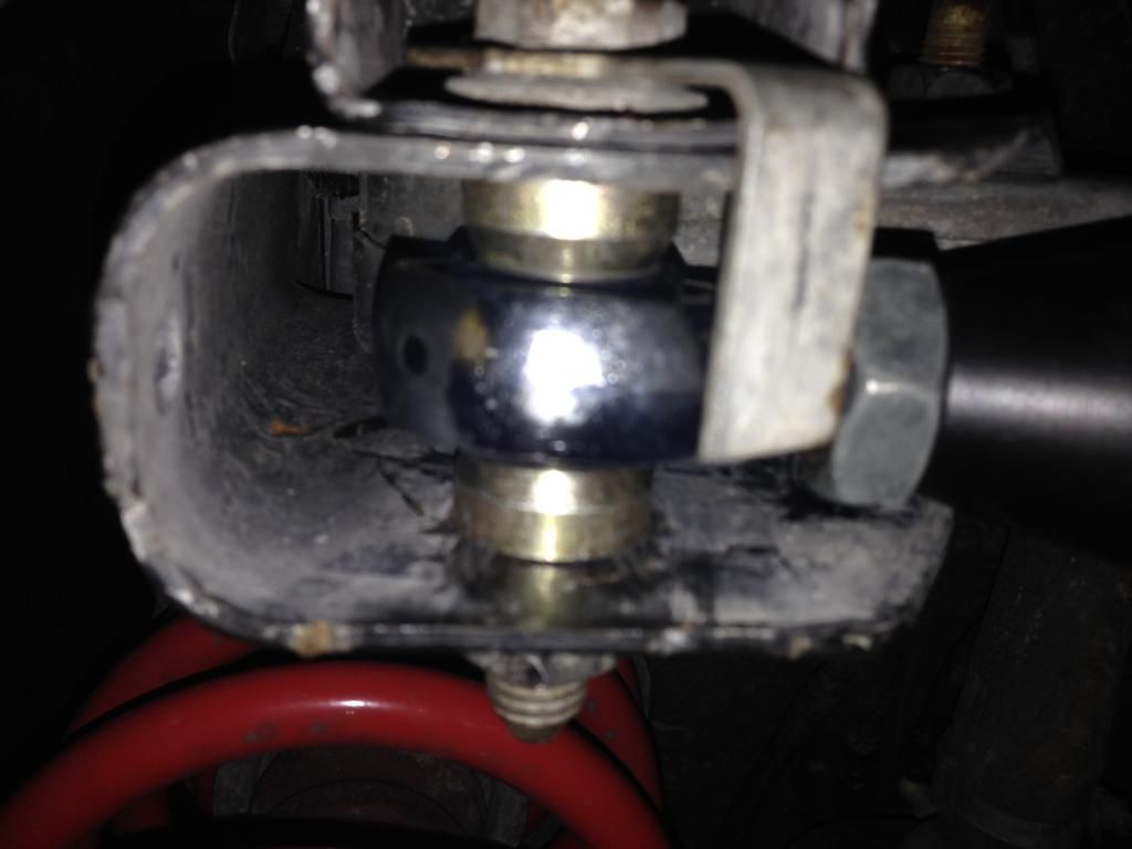

Posts: 309
just took this pics
sorry don't have one out to show what it did.
one thing is that my heim joints are 3/4 and jba are 5/8
i had to use a reducer spacer to make it 9/16 to match the bolt of my kk. now for some reason my friends kk had 1/2 bolts dont' know if that is a diference with the trail rated kks
used two cone spacers it was a little difficult to get them in. the misalignment spacers thAT I GOT were to thick and didn't fit on the kks frame
left was my first bar 1 1/4 dom .120 wall right hd 1 1/2 dom tube .25 wall (it weights like 15 pounds alone)
i did a stronger bar, i believe this part gets a lot of street and better to do it right.
installed passenger side. two cone spacers
drivers side
drivers side moved to the side
note that i installed the bolt backwards. to installed the other way i needed to list the car so it could to in between the spring and by doing that i was gong to misalign that original setting that i had.
i measured the distance between that wheel wall and the spring top mount and adjusted the bar until i got it even on both sides. i am taking the car to an aliment shop to do a precise adjustment and get a correct alignment

Carlos, thanks for these photos. They show amazingly well what is going on in the joint area when the joint is installed correctly. I can think of two reasons my track bar is noisy: 1) lack of cone spacers on the sides of the joint, or 2) a 5/8 in heim joint on a 9/16 or 1/2 in bolt leaves lots of room to move around. We are getting severe thunderstorms here, so my investigation will have to wait until tomorrow!

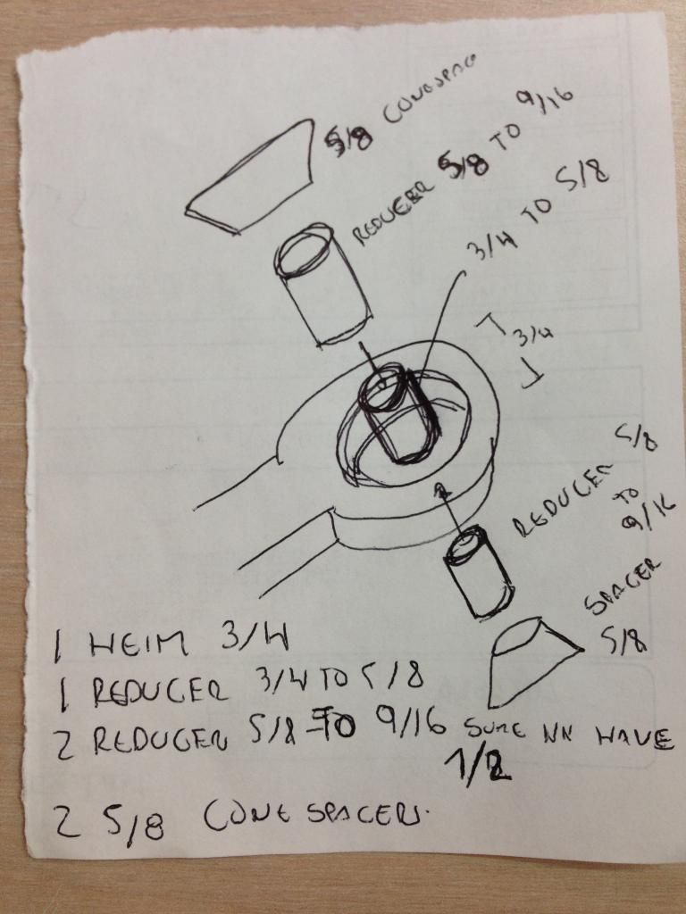

this is what I basically have
is hard to find 9/16 hardware and that is why I went with 3/4 to 5/8 and them 5/8 to 9/16
just make sure your kk is a 1/2 or 9/16 bolt whe ordering spacers or just get both just in case

I have an idea. I'd like to rehabilitate the mounting of my existing track bar.
Assuming mine is lacking cone spacers and JBA's rod ends are 5/8 inch heims mounted on a 1/2 inch bolt, would this take care of the problem?
http://www.qscomponents.com/58to12hms.html
The 5/8 to 1/2 inch high misalignment spacers look like they have cone spacers already integrated into their design.
Now if instead I have a 9/16 bolt like you, I could go with 5/8 inch cone spacers and two 5/8 to 9/16 reducers, right?

Posts: 309
first find out what heim you have on the jba. and what bolt you have then get a reducer and a con spacer. the hi misaligment spacer are to big and you wont be able to fit them on the kk track mounts specially the top one.. you need cone spacers for the kk even the cone spacers are a pain on the butt to fit and you may need to open the track bar mount a little with a pry bar or with the old track bar.
i you have the 9/16 yes. so just order the 4 5/8 cone spacers and 4 5/8 to 9/16 and 4 5/8 to 1/2 just in case. (they are few dollars a pair)

Thanks. Thought that would be the case. It would be easier with the tires off the Jeep and the axle on jack stands. I need a tire rotation anyway! :D
