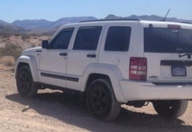

 Post subject: Re: Tomorrow it's going down
PostPosted: Mon Jun 08, 2015 3:06 pm
Joined: Fri May 01, 2015 12:44 am
Posts: 96
PostPosted: Mon Jun 08, 2015 4:55 pm
Gixxa wrote:
Now some white stock looking steel wheels , be looking good :wink:
PostPosted: Mon Jun 08, 2015 5:09 pm
Looks good, you really do have some rake though. I guess 4" rear springs and a 3" front lift will do that. I'd add the top plate and make the clevis a 1/2" to get 3.5" in the front and then throw a few hundred pounds of stuff in the rear to make her squat and break in the rear springs faster.
I know the JBA 6" rear springs come in at ~6.5" when new, but can sag down to ~5.5". I'd assume the 4" start around 4.5" and will break in to 3.5-4". NAM had 4" springs that sagged. I forgot how much he said he measured in the rear.
I was at 23" (4" lift) exactly when the springs were installed. Now I'm sagged to 22.5" (3.5" lift).
PostPosted: Mon Jun 08, 2015 7:15 pm
Posts: 96
I still have sag on drivers rear might add a weight shim under the spring
PostPosted: Mon Jun 08, 2015 8:12 pm
Posts: 1054
Add an isolator ABOVE the spring. I ain't seeing the sag on mime though. Mine was easily fixed with my front struts.
