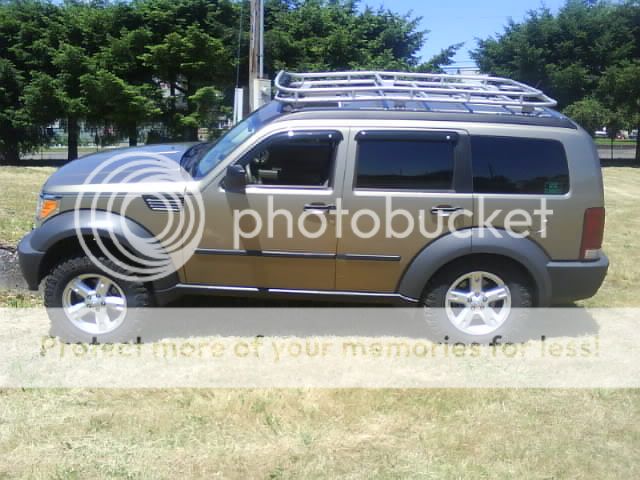

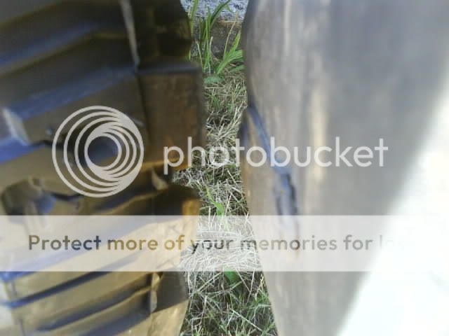

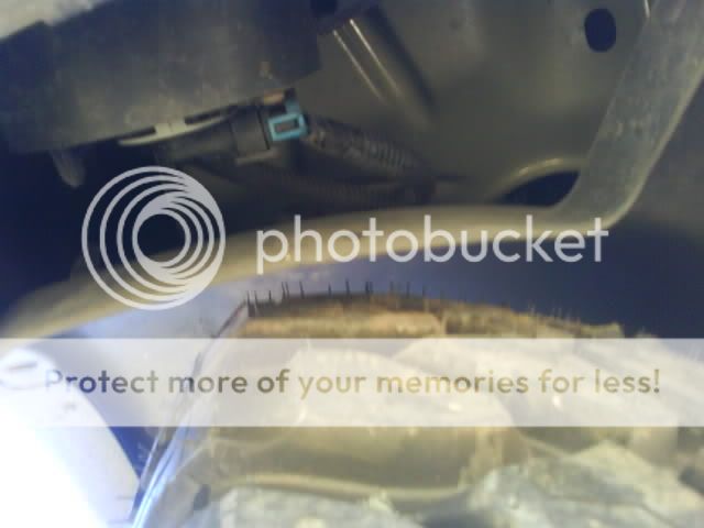

Not 100% sure about the KK. But on a KA we can run 30.5" diameter, 9.65" wide tire without Mods. I do have a 2.5" lift on my ride, but others have used a 30.5" on a stock suspension. The limiting factor is how the front fenders drop straight down at the front and rear.
245/70R17 is what I have on stock rims.
Rear clearance front tire. Full lock, full stuffed.
Front clearance front tire. Full lock, full stuffed.
