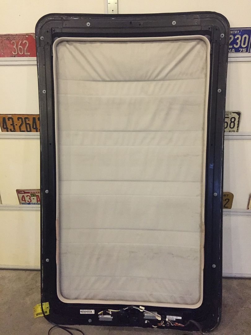

Here's a couple of pics of the used replacement I bought. The current one has about 1/4" gap between the gasket and the bottom of the canvas. The top seems to be locked in place but doesn't move. The motors run and you can hear something moving but that's it. I manually opened the replacement so I'm hoping it will run when I plug it in. I have Google pics, can't get it to post a pic. Sorry

I replaced the assembly this weekend. It was about a 4 hour job. I removed the rear upper trim, then the trim on A, B, & C pillars. On the B & C you have to remove the screw behind the half circle cover. On the B pillar you'll need to slide the seat belt down to see the screw. Then remove screws for the grab handles in the 2nd row. I didn't unplug the wiring. Then I removed the sun visor and also the hook on the other end. Basically the trim, handles, sun visors and sun visor hooks hold the headliner up. The wind lace that surrounds the sky slider opening is part of the sky slider assembly. A few gentle pulls and the headliner comes down enough to get at the 14 studs to remove the nuts and unplug the 5 connectors. The rubber seal on top is slid over the outer edge of the frame assembly and can be pulled off. I then took a sharp Snap-On gasket scraper, sprayed the urethane with a water/soap solution and cut through the urethane without scratching any exposed areas. Then the assembly was lifted out, remaining rethane was removed, scratched paint was touched up with a brush (under the seal so it won't be seen), new 5/16" bead of urethane, repacement top was set in place and bolted down. Wiring was attached, opening was attempted, motors didn't even make a click. Took the relay out of my old assembly and put it in the replacement and everything works! Then all the trim was reinstalled. Great buy for $200! I took pics and have them on Photobucket.

[img][IMG]http://i1045.photobucket.com/albums/b453/acerv73/Mobile%20Uploads/DF482B9A-3535-470D-A741-11ED826982B1_zpsmdbvk9u2.jpg[/img][/img]
I give up, it gives me 4 options: email & IM, Direct, HTML, or IMG. This is IMG option
 Post subject: Re: Sky Slider replacement
PostPosted: Mon Feb 29, 2016 11:02 pm
Posts: 3100
Location: Philadelphia, PA
Fixed it. Direct was the option you needed. I deleted the rest of the code except for one set of IMG tags.
