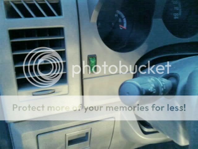

ESP Off Switch

Scar what size switches are those. I like the way those look there.
When you were in there was it possible to put more of the in those rows?
1951 WILLYS FAIRMONT PICKUP (HIGH COMPRESSION SUPERCHARGED FLATHEAD)
1956 WILLYS PICKUP ( FIRST ZJ POWERED PICKUP)
2012 LIBERTY JET (WIFE)'
2012 LIBERTY SPORT BLACK FOREST GREEN. SOON TO BE THE ONLY 2012 RENEGADE
 Post subject: Re: switches
PostPosted: Fri Mar 25, 2016 11:57 pm
Posts: 1503
Location: S.W Washington
Just a standard rocker(O'Reilly Automotive $4). There is not a lot of room on the dash. Maybe could have added 1 more next to the ones I have.
The bezel around the cluster is just clipped on. Lower the steering wheel and pull the bottom out. Then you can see what you are dealing with behind it. On the switch to the right of my steering wheel (ESP OFF) I mounted it a little close to the outside and had to trim some plastic behind the bezel to get it to fit. On the left is my Halo switch. It is lighted and a little bright when on at night.

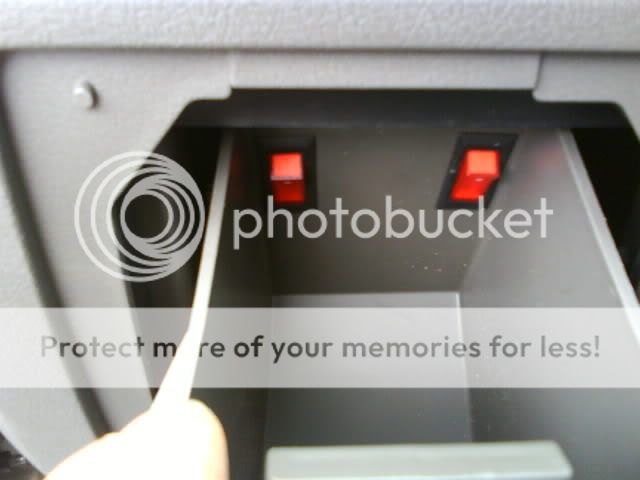

The storage box on the left (my rack lights), just open it and pull up to remove it. It is plastic hinge clipped at the bottom. I could have put 2 more rockers in there with no problems. I chose that location so they would not be bumped by accident. The Off road light laws are strictly enforced in my area, with huge fines if you have them "on" while on the road.
So far I have been lucky and have not gotten sited for not having covers on them.
