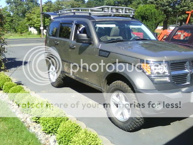

Here are my 245/70R -17 on stock 17" rims.

Lots of pics in the "what have you done to your kk today" thread on page 461 and 462. Stock except for the tires.
